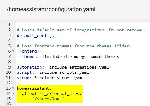

I have followed the steps here, but I am still not able to create a text file.
Here are the steps I have done:
  1. Created the folder and set the permissions as 776 (I don’t care which folder it is, I just need a folder to hold the text file)
  2. Added it to the allow (configuration.yml)
  3. In Integrations, added a file and set the path, then rename it…this seems very strange, shouldn’t there be a file path, file name, and overall name?
  4. Created an automation, for now just trying to write out anything:
    alias: WriteFileTest
    description: “”
    triggers:
  • trigger: time
    at: “16:11:00”
    conditions:
    actions:
  • action: notify.send_message
    metadata: {}
    message: “"Test"”
    entity_id: notify.FurnaceOpTime
    mode: single
Any suggestions as to where I am not understanding this?
Looks right to me. Not sure what I’m missing.
For troubleshooting steps, you might try a few things:
  1. Instead of a sub-directory, put the file right in /share.
  2. Instead of /share, try /config
    (That “share” directory has some special considerations in HA.)
    (You’d have to make these changes in both the File integration and the allowlist.)
  3. Use Developer Tools / Actions to test the notify.send_message syntax before trying it in an automation.

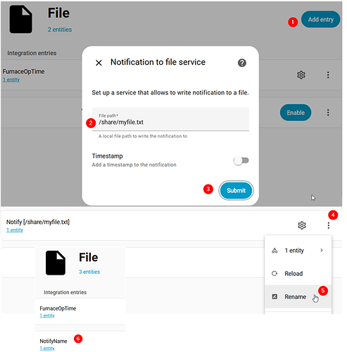

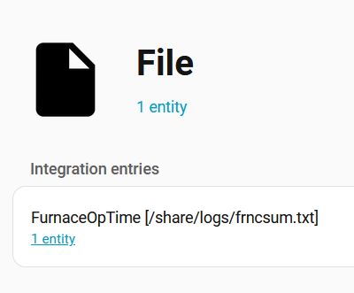

Thanks Tom, I got it to work now. I must say that the Developer Tool → Action works very well. From that, I was able to determine a few things that I will note here in case it helps someone in the future.
When you create a File (Integration) and add an Entry (“Setup Notification Service”), it will ask for the file path, ensure to include the path and the name of the file you want (Note 2 on the enclosed screen capture). An important note is that once you set that file path and file name, it can’t be changed (so it seems, correct me if I’m wrong on this). Next, rename the Entry (Notes 4 and 5) to match what you have in the entity ID (in this case shown on the screen capture, it would be NotifyName, entity_id: notify.NotifyName). You can leave the file path in the square bracket as a reminder to the file path and file name used, but that is only a comment/note, it doesn’t control the file path and name).
I used the /share folder as it seemed to be one that allowed files to be created. There are likely other folders that work, but I’ll go with it for now.
Interesting. I’m not a big fan of “dumbing things down” to use the UI instead of a config file. This would seem to be a good example of why.
Just for fun, I went digging to see where these file entities end up being defined. It’s in the .storage directory, in a file called core.config_entries. One line in that file contains (for example) the string {"file_path":"/config/burner_summary.txt","name":"burner_summary","platform":"notify"}
This seems to confirm your finding that the name and the file path can differ. I recall having to delete and re-add these file notify entities a few times myself, now that you mention it.
Thanks Tom, yes a few strange things with the UI. It would be better if they’re going to use a GUI, that it has the ability to modify the file path and other settings.
I don’t have the .storage directory you noted, perhaps you’re using HA in a Docker? Also, a strange thing is that in my automation I have to use entity “file” and not what I named the file (furnaceoptime) Click on entitiy and then click on the “Cog wheel” settings and change the name there. Very convulated indeed but at least I have figured it out!
At least it works and is updating the text file correctly.
Chris
