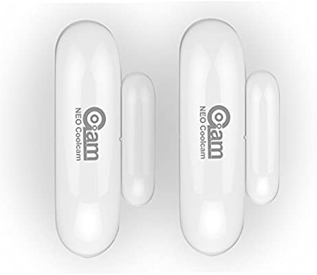

I have just bought some WiFi door / window sensors off eBay for £9.10 each.
Search for NAS-DS01W although I don’t know what they are like yet.
They also do a PIR motion sensor called NAS-PD01W

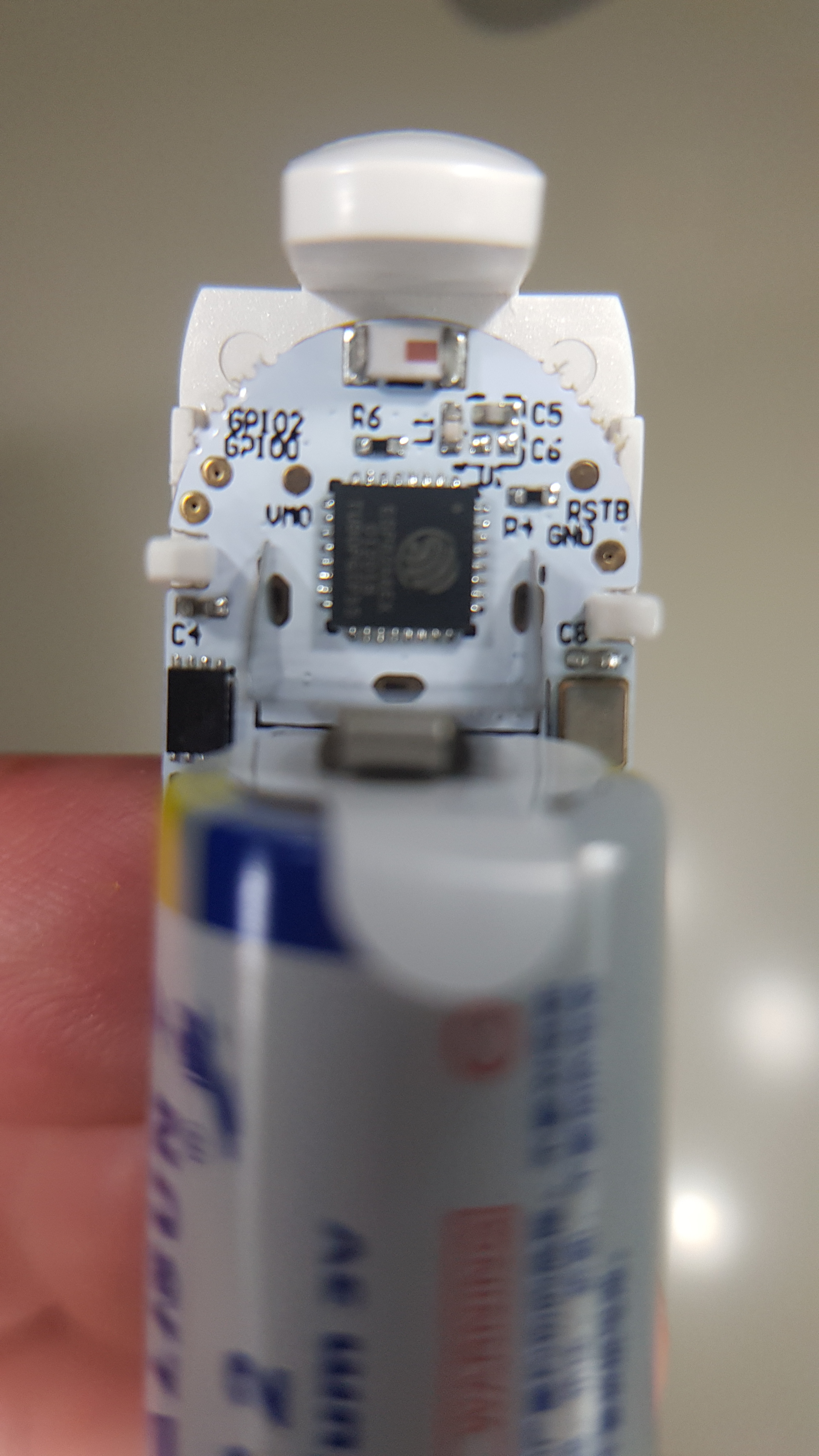

I recently bought these:
They are not too laggy (1-2 seconds) in a 90 sqm flat. The caveat is that it’s only pollable thru TuyaSmart App and HA’s internal Tuya component currently doesn’t support this device but it’s expected to be in the near future.
One possible way around this would be trying to flash tasmota or some other variant since the board has contact points:
But I’m too noob to even know where to start.
