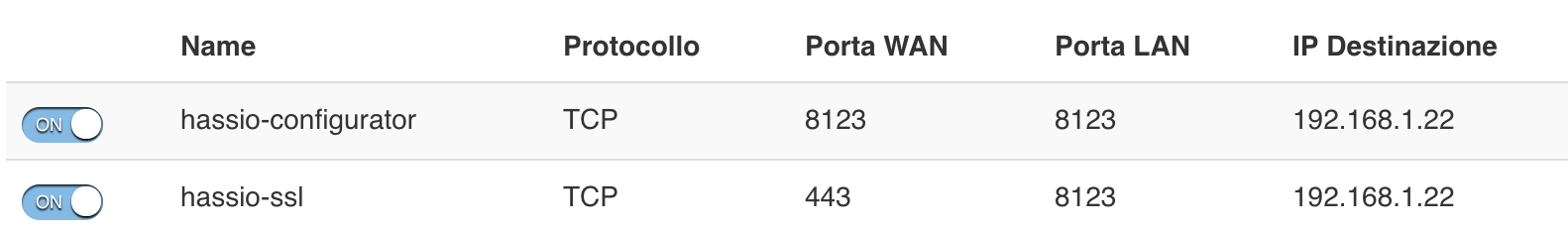

so with your forwarding your doing 8123 local -> 443 external?
yes, exactly!
Here is what I would suggest you do.
Forward 8123 -> 8123 or 443 -> 8123. Don’t forward anything else. Going straight 8123 -> 8123 will result in less noise in your router logs or people accessing your front end as 443 has a lot more scanning done on it than 8123. 8123 -> 8123 is not more secure but just doesn’t have as much noise. Also, some businesses may now allow your to egress via 8123 from their network. (my work does this for instance)

Did it, but with no success:
