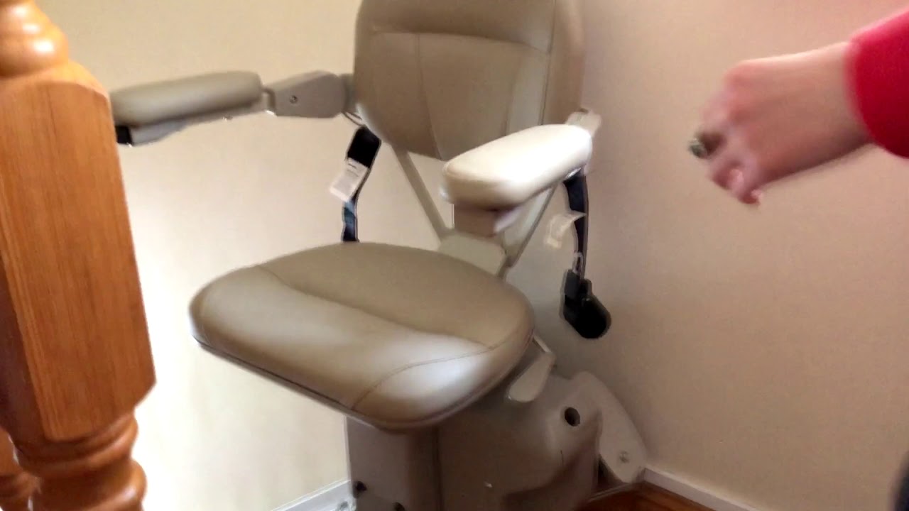

I would like to use Broadlink RM Mini 3 to control my stair lift
For that, I need a long press of the button.
Calling the lift takes about 40 seconds and during this time the remote control button must be still pressed all the time.
At the moment I have been able to program a long press for up to 6 seconds.
Is there a chance to program a constant long press for 40 seconds?
It would be very helpful for me and for many disabled people.
I’m asking for your help.
Model of my stair lift: Bruno SRE 2010 ELITE

unfortunately broadlink software still does not offer this possibility: /
Hi @Przemek_Kuniniec. Can I take a look at the IR code?
