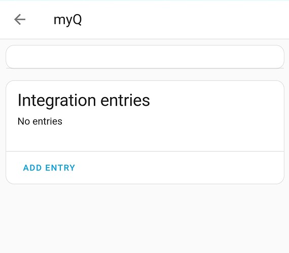

I still have a message about MyQ. I thought it would go away but it hasnât. Does anyone know how to get rid of this? Below are two screenshots that show the message. It says to remove integration entities but when I click on the link I donât have any integration entities.
Hopefully This works for you.
Can you please write up an issue on github mentioning that âYou canât delete a deprecated integration after itâs removed from HAâ.
I decided to search devices and entities for MyQ. I found three entities and one device. Once I deleted all of them and rebooted, the message went away. Should I still submit an issue since I no longer have it?

I stumbled here for the same reason, but have a slightly different solution: when clicking the error message it would take me to a broken / useless page that should have had a delete button. I poked around a bit and went over to my Devices, found one of my garage doors, then by clicking through from there I was able to see and delete the integration.
