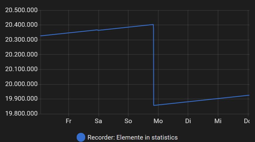

I don’t know which HA Core release finally brought this, but deleting statistics of orphaned entities is working from the dev tools > statistics section for a while.
So I was finally able to remove statistics/LTS for 114 orphaned/disabled entities from my database which removed almost 550.000 rows from the statistics table.
