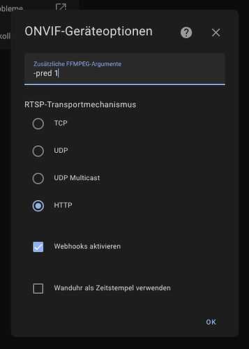

Thank you very much, I’ve been trying to integrate the E1 Pro into HA for ages. Now it finally worked with your post!
However, you have to change the settings from TCP to HTTP afterwards. This finally worked for me and I get both streams displayed! Thank you very much!
