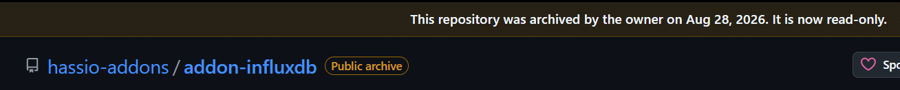

The link you provided says it has been archived by owner, this is most likely what is causing the repair issue.
Judging from the deprecation warning I will have to delete it and no longer have anything feeding my Grafana graphs.

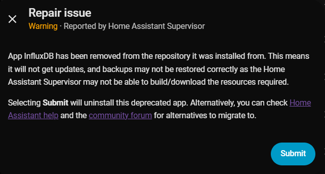

My HA told me today that influxdb is no longer supported?
What else can be used and how can i preserve my historic data?
Can you post the actual message?
I am guessing there is a clue in there.

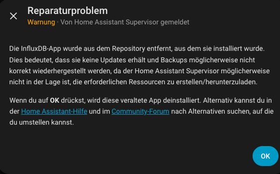

here the german version of the message:
Translated:
Repair issue
Warning • Reported by Home Assistant Supervisor
The InfluxDB app has been removed from the repository it was installed from.
This means it will no longer receive updates, and backups may not restore correctly because the Home Assistant Supervisor may be unable to create or download the required resources.
If you press OK, this obsolete app will be uninstalled. Alternatively, you can look for replacement options in the Home Assistant documentation and Community Forum.

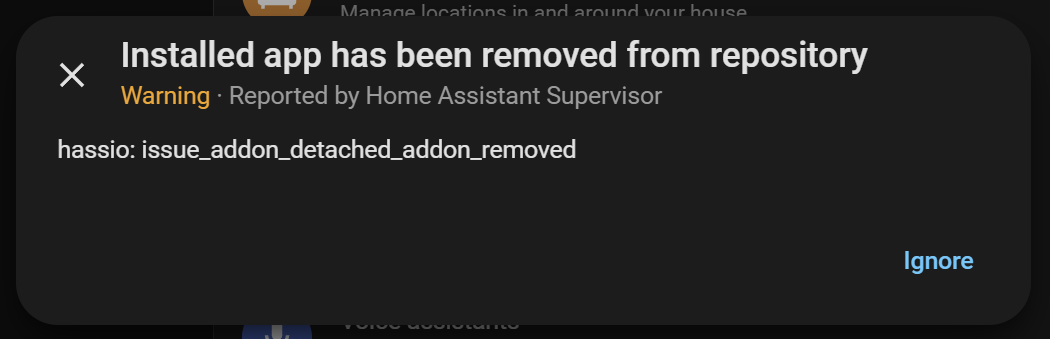

EDIT: I should also add that the repair message isn’t very helpful as it doesn’t say what addon / app is being removed:

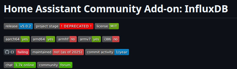

:warning: InfluxDB Addon is DISCRAPED :warning:

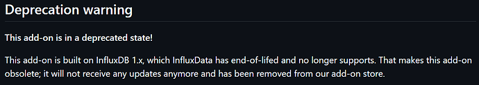

Deprecation warning From the Github site
This add-on is in a deprecated state!
This add-on is built on InfluxDB 1.x, which InfluxData has end-of-lifed and no longer supports. That makes this add-on obsolete; it will not receive any updates anymore and has been removed from our add-on store.
