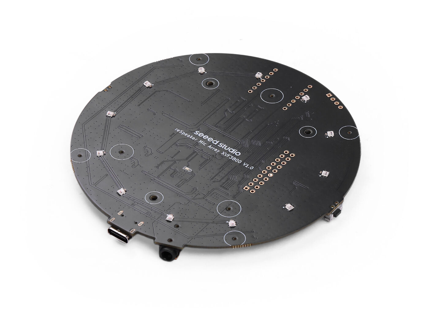

You may have heard about XMOS XVF3800 and ReSpeaker 4-mic board, based on this chip. The board is not on cheaper side, but it should be able to cover the most painful gaps, which other similar boards on XU316 may be lacking - big noisy rooms. I’m still testing it, but it works noticeably better than Respeaker Lite, due to its beam-forming and XMOS proprietary AEC and NS algorithms.

There’s still work to do. E.g. there’s no exposed light entity for user to control (LED lights are controlled by I2C instead of addressable GPIO). Also there’s no additional buttons, that would aim to change volume and work like multi-action button (similarly to PE and Koala). So all the controls (except bi-directional mute) are done programmatically.
But all other functionality works, and i aim to provide thorough instructions and pre-built firmware to some Koala-like ready to use device with volume knob, speaker and enclosure.
If you have 1.0.5 alpha version of DFU installed on your board, please use official instructions to flash 1.0.5 version from my repo or official repo, since it has same version number with alpha, thus won’t be updated automatically. Otherwise you’re good to just flash ESP chip with example YAML config from the repository - it should work out of the box.
