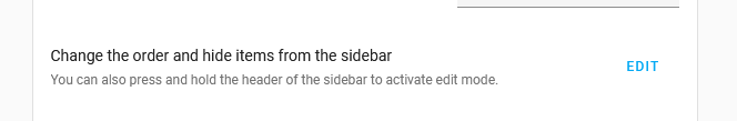

Login as the guest, on the profile
Remove all the sidebar items you don’t want the guest to see.
Since 2025.6, this is stored in the user profile.
