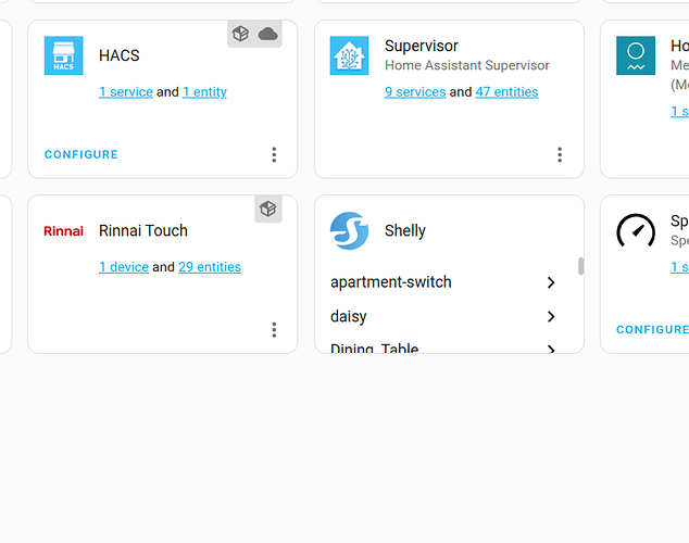

I have a 3-zone setup with refrig AC. The way I use the setup is mostly in Auto mode, occasionally setting custom temps but mostly turning the master Heat/Cool/Fan control on/off and letting the schedule do its thing.
I have added the integration however the controls don’t seem to do anything. Nothing is in sync with the actual unit - HA is displaying actual mode & room temp, but set point temp is 0, and sending any Heat/Cool/Fan/Temp commands does nothing. It all works fine via the Rinnai Touch app.
