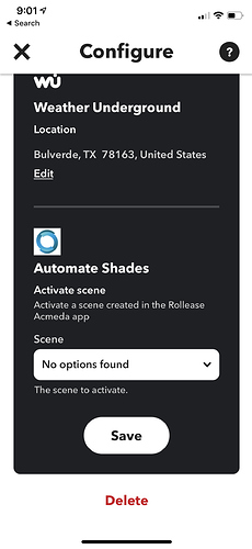

Thanks cryptelli. That is what I tried. I deleted my two setups (one for sunrise and one for sunset) and tried to redo everything but when it gets to the part of having to choose the particular scene that I want to activate upon sunsrise/sunset, it says “no options found.” I even went into the Rollease app itself, deleted my scenes, and recreated them. Everything still works fine with Alexa so that tells me that the Rollease system is still communicating with other systems.

As everything is working outside of IFTTT can you check that your Automate Shades service in IFTTT has a status of ‘active’ as per my screenshot above.

Also getting ‘Options Unavailable’. Brand new installation with new accounts. Using the iOS app for the hub works fine. Cannot get it to work on Google Home/IFTTT. Scenes are made in iOS app. Any ideas?
Status is active on IFTTT
