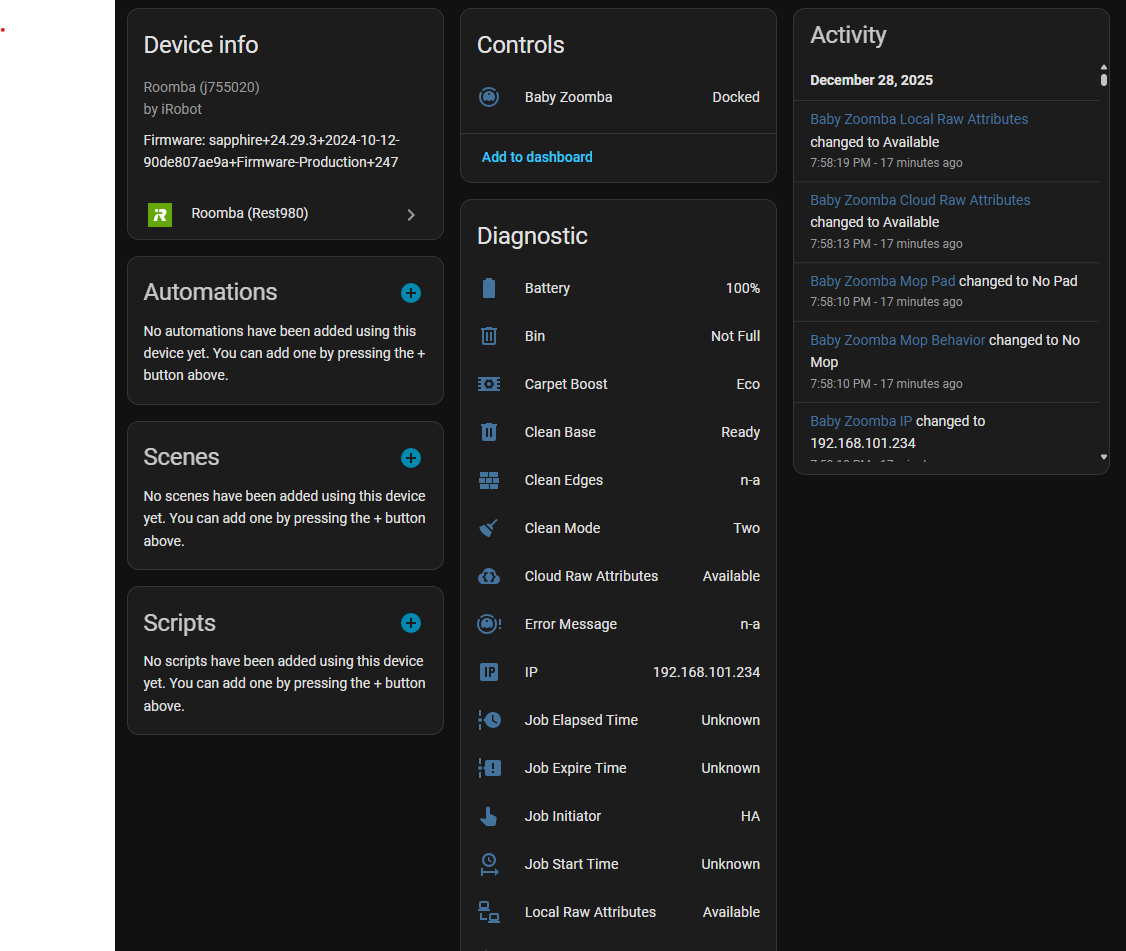

I have Roomba j755020 (Firmware: sapphire+24.29.3+2024-10-12-90de807ae9a+Firmware-Production+247)
Installed rest980 as an addon
installed roomba_rest980 and it connects on http://localhost:3000 (and connected to cloud with my u/pwd)
Under device, I do not see Sensors or Configuration sections. I do have Device Info, Controls, Diagnostic, Activity.
Thoughts on what I am doing wrong? Thx
Could you please send a screenshot of the error? I’d be able to better assist you with one
no error but here’s what I see:
Could you send the HA logs?

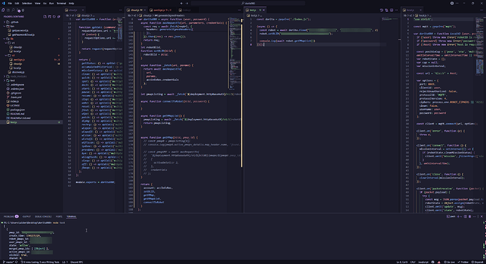

Hey all! Wanted to share a progress update. Currently working on adding cloud support to dorita980. Next, will work on adding to rest980, then my integration.

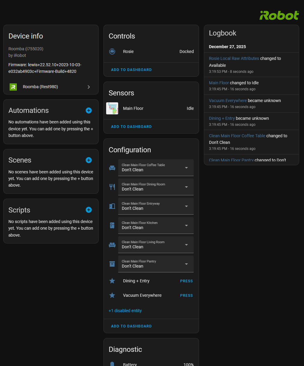

I now have the integration installed and working. I was able to set the select.clean_main_floor_office drop-down to “One Pass” and then click the “clean” button from the vacuum’s entity. It worked!
Now I want to automate it. How would I command the vacuum to clean my office when a trigger fires?
Is it a two step process where it has to first change the value of the select.clean_main_floor_office to “One Pass”, and then send the “clean” command to the vacuum entity?

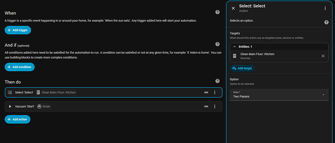

Yes! The select has to be changed to One Pass or Two Passes, then press the Start Cleaning button. The flow looks like this:
Here’s the YAML for the actions:
actions:
  - action: select.select_option
    metadata: {}
      entity_id: select.clean_main_floor_kitchen
      option: Two Passes
  - action: vacuum.start
    metadata: {}
      entity_id: vacuum.rosie
    data: {}
You can, of course, change “Two Passes” to “One Pass” but it is case sensitive (like all selects in HA)

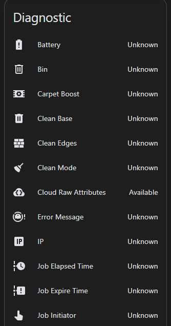

Feeling like a bit of an idiot here, but newbie question…
I’ve installed Rest980 and configured the integration with my Roomba i3. When I look at the attributes/diagnostics for my Roomba, everything is listed as “Unavailable”.
But, if I go to the Rest980 API URL, all the “missing” values appear to be present in the API reply.
I think I’ve configured everything correctly, but I’m absolutely stumped why HA doesn’t seem to be reading any of those diagnostics from Rest980.
Thanks in advance!
I believe this was fixed in v1.17.1, this has to do with the legacy attribute handling, please update to that and try! If the issue persists, please make an issue on GitHub w/ rest980 output and HA logs [if the integration makes any]
