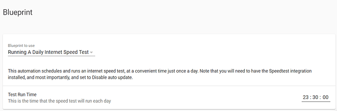

There might be a number of reasons you want to monitor your internet speed: troubleshooting speed issues, checking that your ISP is delivering what they’ve promised, or just plain curiosity. The Speedtest integration is useful, but by default - it runs hourly, which will almost certainly impact any other activities that are happening, e.g. streaming, video calls, games, etc. To keep this sensor in check, we are going to set-up an Automation to run daily at a quieter time.
For a more advanced manual configuration of the speedtest, check out: https://cyan-automation.medium.com/configuring-an-internet-speed-test-sensor-in-home-assistant-309e9bec5a74
Prerequisites
You will need to complete the following pre-requisites to get this blueprint to work correctly.
  1. Install the Speedtest integration
  2. Set the intergration to run manually, this can be done by going into Integrations, selecting Options on the right Speedtest tile, then checking the box next to Disable auto update.
Blueprint
Click the badge to import this Blueprint: (needs Home Assistant Core 2021.3 or higher)
blueprint:
  name: Running A Daily Internet Speed Test
  description: This automation schedules and runs an internet speed test, at a convenient time just once a day. Note that you will need to have the Speedtest integration installed, and most importantly, and set to Disable auto update.
  domain: automation

action:
  - service: speedtestdotnet.speedtest
