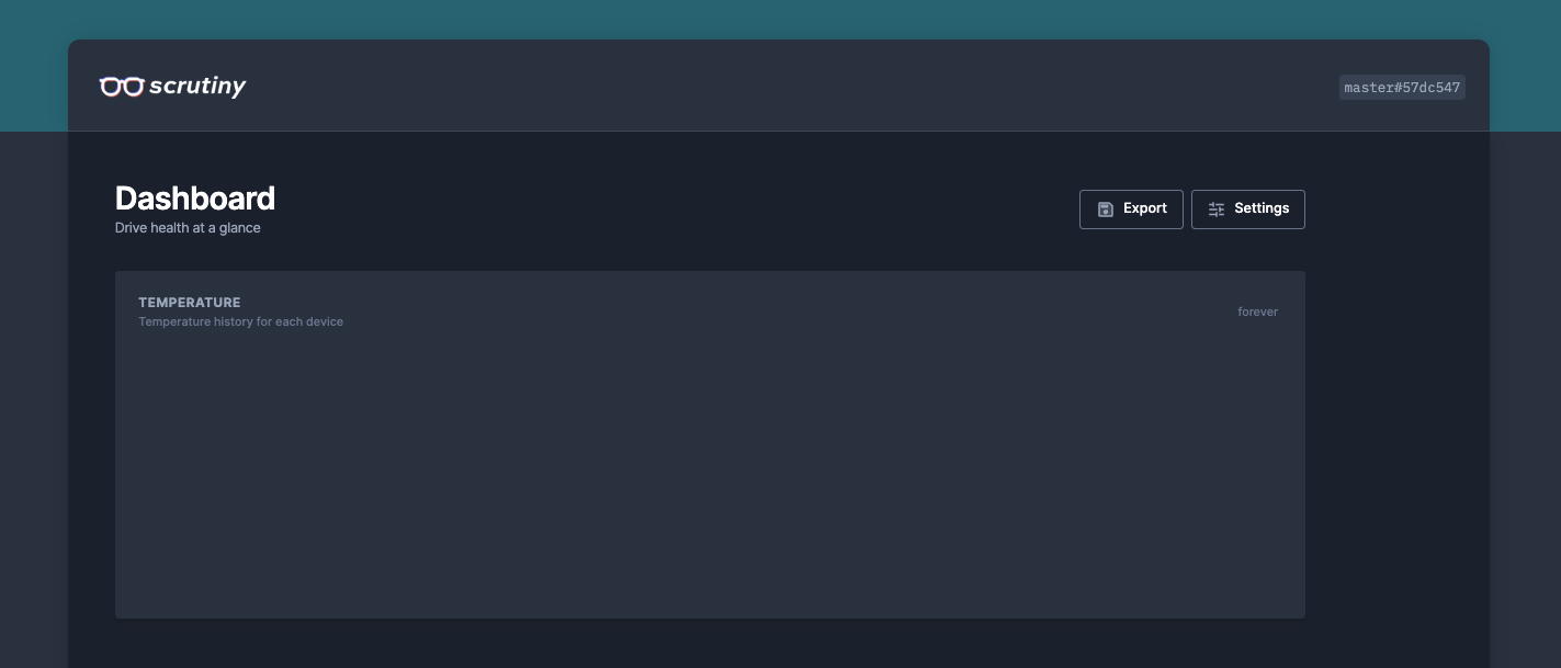

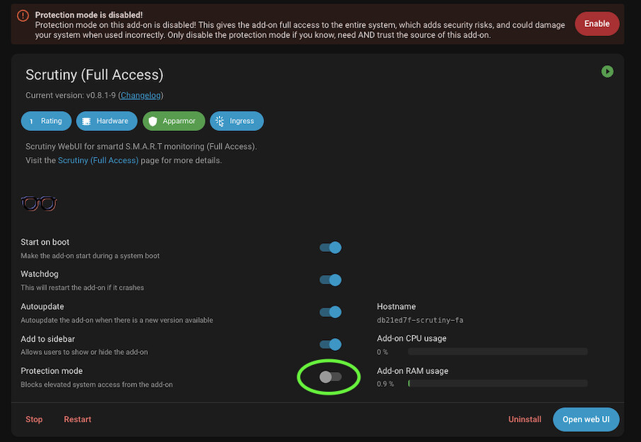

There’s an add-on for S.M.A.R.T you can use: Home assistant addon : Scrutiny (SMART dashboard)

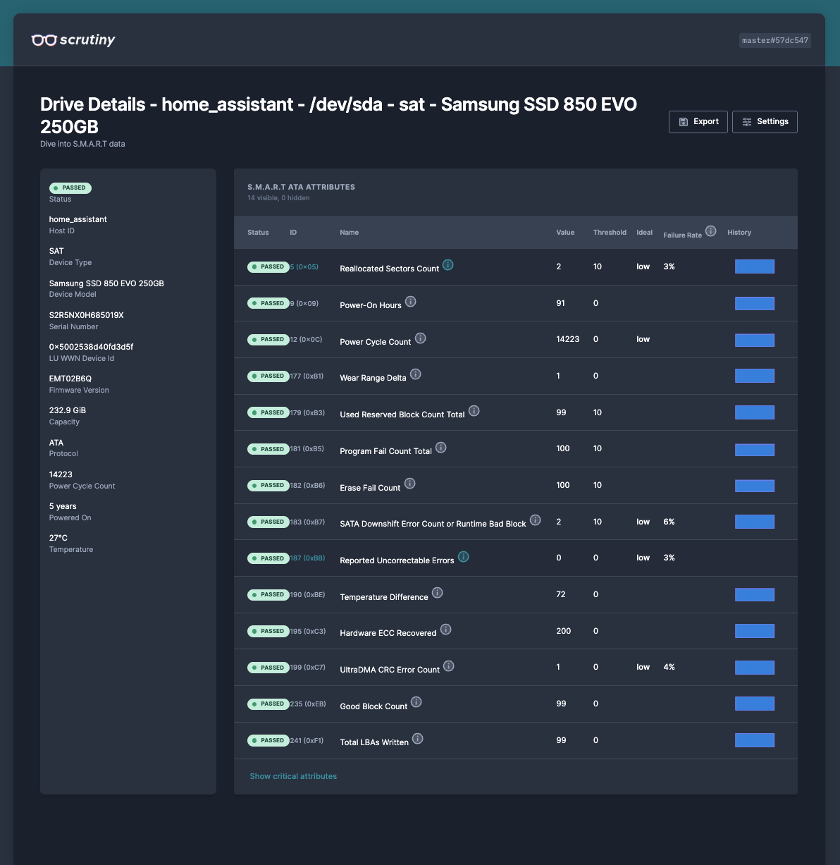

[home_assistant - /dev/sda - sat - Samsung SSD 870 EVO 1TB]
Last Updated on March 26, 2025 - 17:50
Status            Temperature          Capacity        Powered On
Failed            30°C                 931.5 GiB       3 years

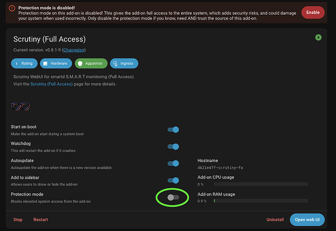

Thank you! You were spot on!! After turning off protection mode for the addon, I was able to get it running and unfortunately it proves that the drive is “mostly dead”. Still under warranty, so I guess I’ll have to replace it with something else while I wait for them to send me another drive.

quick update… missed the post about disabling the Protection mode.
I wouldn’t recommend keeping this on. my intentions are to enable it maybe quarterly (for a day) to allow for some testing to run, then disable it and then turn off the add-on to reduce resources.
But after enabling it, I was able to see my SSD and get stats.

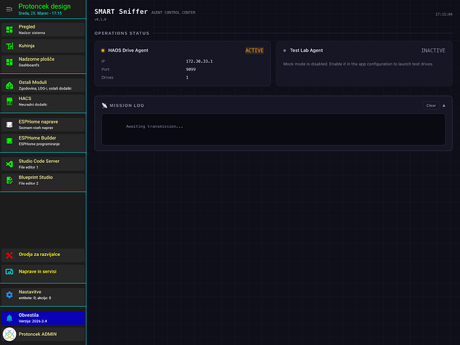

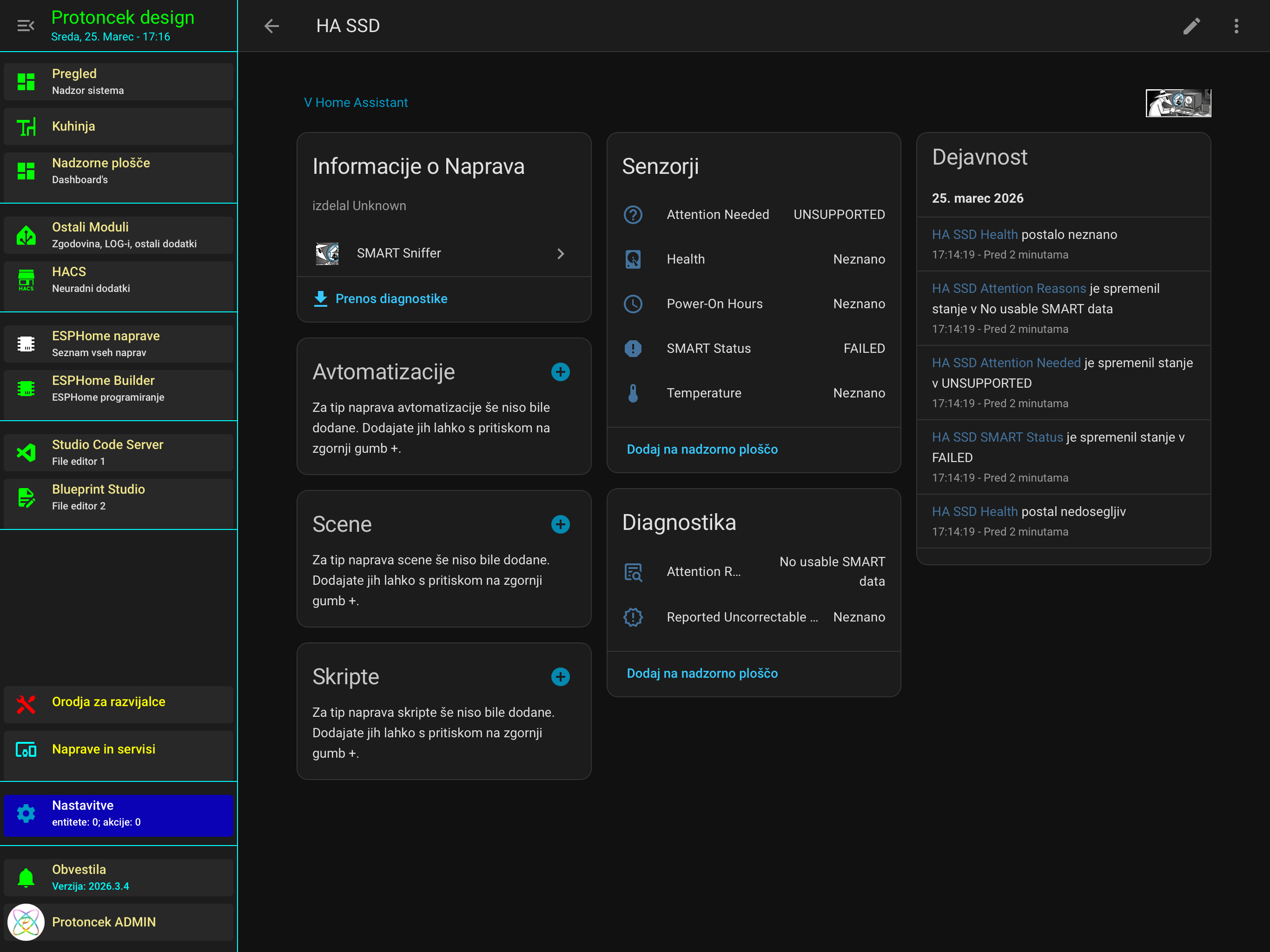

Hm… i installed it on my HAOS machine, but hacs add-on finds no sensor values (all are unknown).
is that connected with tom’s question about smartmontools? Note that haos by itself doesn’t have smartctl installed.
If the “smart-sniffer-app” doesn’t detect your local HA-OS drive correctly then the “smart-sniffer-integration” can’t show anything.
Look at the “smart-sniffer-app” - logs.
For me it’s not working (Pi5 / PCIe M.2 HAT für Raspberry Pi 5, M-Key, Compact / Raspberry Pi SSD, 256GB).
2026/03/25 09:56:58 smartctl -a /dev/nvme0 exited with error (may be normal): exit status 2
2026/03/25 09:56:58 cache refreshed: 1 drive(s)
Pretty much similar/same error here, yep…

Hey Protoncek ~ thanks for trying it out and taking the time to comment!
“Unknown” values usually means the add-on found your drive but smartctl couldn’t read the SMART data from it. That’s actually working as designed ~ the integration marks those as UNSUPPORTED.
A couple questions so I can help narrow it down:
  • What hardware are you running HAOS on? (Pi, mini PC, VM, etc.)
  • What kind of drive? (SATA SSD, NVMe, USB, virtual disk?)
  • Can you check the SMART Sniffer App logs (Settings → Add-ons → SMART Sniffer App → Log tab) and share what you see?
Some setups just won’t work with SMART ~ virtual disks in VMs, USB-attached drives, and certain NVMe controllers can all block the passthrough.
Once I know your setup I can tell you if it’s a limitation or something we can fix. We’re in beta, so I want to iron out all the cases we can. :slight_smile:
~DAB
Hey Baxxy13 ~ thanks for the logs, and congrats on being one of our first Pi 5 users! We just added ARM support in this release so your feedback is really valuable. :heart:
I have a strong suspicion about what’s going on. The add-on container currently requests SYS_RAWIO privileges, which is enough for SATA drives but NVMe drives need SYS_ADMIN as well. Your Pi 5 is running NVMe over PCIe, so the container likely can’t send the admin commands smartctl needs.
Can you do me a favor and check one thing? In your SMART Sniffer App log (Settings → Add-ons → SMART Sniffer App → Log tab) ~ do you see a line that says cache refreshed: X drive(s)? I need to know if X is 0 or 1. If you could share your whole log, that would really help, too.
I’m fairly confident this is a container permissions issue on my end. The add-on currently requests SYS_RAWIO which covers SATA drives, but NVMe drives also need SYS_ADMIN to send admin passthrough commands. We had this on our roadmap. I’ll push an update with the fix ~ if you can confirm that drive count for me I’ll get it out faster.
~DAB
I’m running haos directly on (older) intel nuc skull canyon (i7 cpu), disc is m.2 ssd 512gb - some noname one (taken from chinese mini pc, bought recently on banggood) but scrutiny sees it, also smart data are there. And, as you said, your addon sees one disc, just smart data is not there.
Hey Protoncek ~ thanks for the details, that tells me some great clues. Your M.2 SSD on the NUC is almost certainly NVMe, and the fact that Scrutiny can read it confirms the drive supports SMART just fine ~ the issue was on our end.
We just pushed v0.2.5 of the app with the fix. The container was missing the SYS_ADMIN capability that NVMe drives need. We’re intentionally building with the least amount of access required at each level for security reasons ~ so we’re testing this targeted fix rather than just throwing full access at it. Go to Settings → Add-ons → SMART Sniffer App and you should see the update.
Give it a restart after updating and let me know if your data comes through.

No, still the same. No smart data here…
No problem. Logs from 0.2.5
