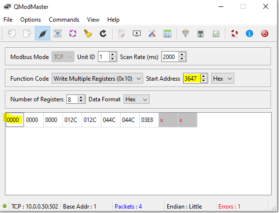

Thanks for putting this up. I can connect to the inverter fine and read the various registers, but they don’t seem to align with the registers you provided, and the registers in the Excel Modbus doc are different numbers (everything starts with 4xxx) so if I follow your guide, do I just type 7F19 where it’s highlighted yellow and write multiple registers to 3608, or if I wanted to set charging to Mon-Sun, 75%, then it would be 7F4B? Then for register 3606 if I wanted to set charging time start of 11:00am, then I just write Hex code of 0031 in the first box? And the same for register 3647, I just put 0001 in the first box and write the register to set the working mode?

I am getting the same issue as a few posts above. I can read data but when I try to write I get no response on the battery, and the same in QModMaster, illegal exception, even though it connects and reads fine. This is using a EW10RS232, and all reading of data working fine. Weird.
EDIT: I give up, this doesn’t make sense anymore. Following all the guides, and following the H2 Modbus guides I get totally different results from Qmodmaster and can’t get anything to work except to read the basic parameters. I think it might be easier to just sell this stupid inverter and get something that actually works with HA and has some community support. Nobody seems to want to help either. Only thing I can think of is to re-flash the firmware, but that doesn’t seem like an option.

I got it working with the registers @stanus74 suggested. Are you using the correct base address? I see 1 in your screenshot but for me, i need 0. Not sure for you but you could try it.
SAJ use 0 based Modbus Protocol. is important to check the settings in QModMaster, see in Screenshot.
The Slave address is 1
is set as offset 1 in a 0-based Modbus protocol, all registers are shifted by +1
good info about Modbus
@mike_home_84 in the settings is the wrong Base Addr: 1
Thanks mate, yep I worked that out when I was reading the registers and everything was offset by 1 ![]()
