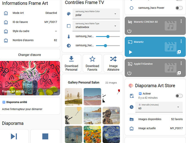

Hi all,
I've developped a very enhanced custom for TV frame, works also with non frame samsung :
TheFab21/ha-samsungtv-smart: Samsung TV Frame integration for art mode :
key features :
  • Oauth2, smarthings, websocket and ip control
  • Dedicated gallery card, to change, select, upload image
  • multi frame tv support
  • Available languages : fr, en, es, it. hu, pt-BR
Just wanted to thank you for this. I have multiple Frame TV’s and I have been so frustrated with the HA solutions up to this point. This is HUGE for me.
