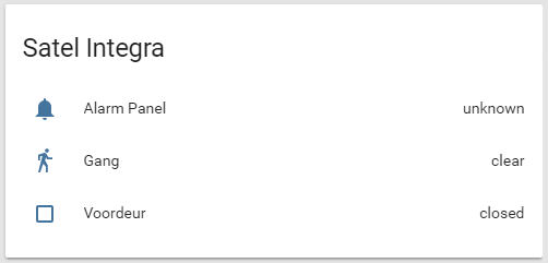

First of all, thank you for a lot of work you have done. I was glad to see this component en gave it a try.
After a lot of testing / trying, i can’t get it to work. Maybe someone can help me out.
I have an Satel integra 64 plus firmware 1.17 and the ETHM-1 v2 firmware 2.04, with 14 zones connected. (window and IR sensors)
In DloadX i have turned off encryption for integration protocol on de ETHM-1 module.
In de confugration.yaml just 2 zones for testing, the sensors are visible with the encryption off but the status won’t change.
With the encryption on, there are no sensors visible.
So i think there is a connection with the Satel panel when the encryption is off.
Satel Integra

Is there a setting i missed?
Hello.
You need to upgrade python. Your version does not support asyncio.StreamReader readuntil.
Yes it works now i upgraded to HASSio. I was using hassbian. Thanks for helping me out.
