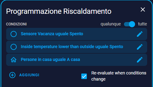

Hi to all,
i use scheduler custom component from about one year.
All work as it should except re-evaluated option when condiction change.
Example:
I’ve set home temperature to 18.5 when family is home but i’ve changed it to 17.5 if family goes out (time slot 0.00 - 8pm)
If during afternoon family goes out scheduler component doesn’t set to 17.5 but it remains to 18.5.
I’ve set it like the image below.
What’s wrong?
Anyone has this issue?
Regards,
Alessandro
You can debug the issue by enabling log output for scheduler.
For example by adding to configuration.yaml:
logger:
default: warning
logs:
custom_components.scheduler: debug
When any entity used in the conditions changes, you will see:
State of (…) has changed, re-evaluating actions
And then you should see either:
Conditions have failed, skipping execution of actions
In case the conditions are not (all) met.
Or:
Executing service (…) on entity (…)
In case the conditions are met and the action is executed.
You can also check the history or logbook of the entities used in the conditions, to compare the states with your conditions (and verify whether you agree if the conditions are met or not).
