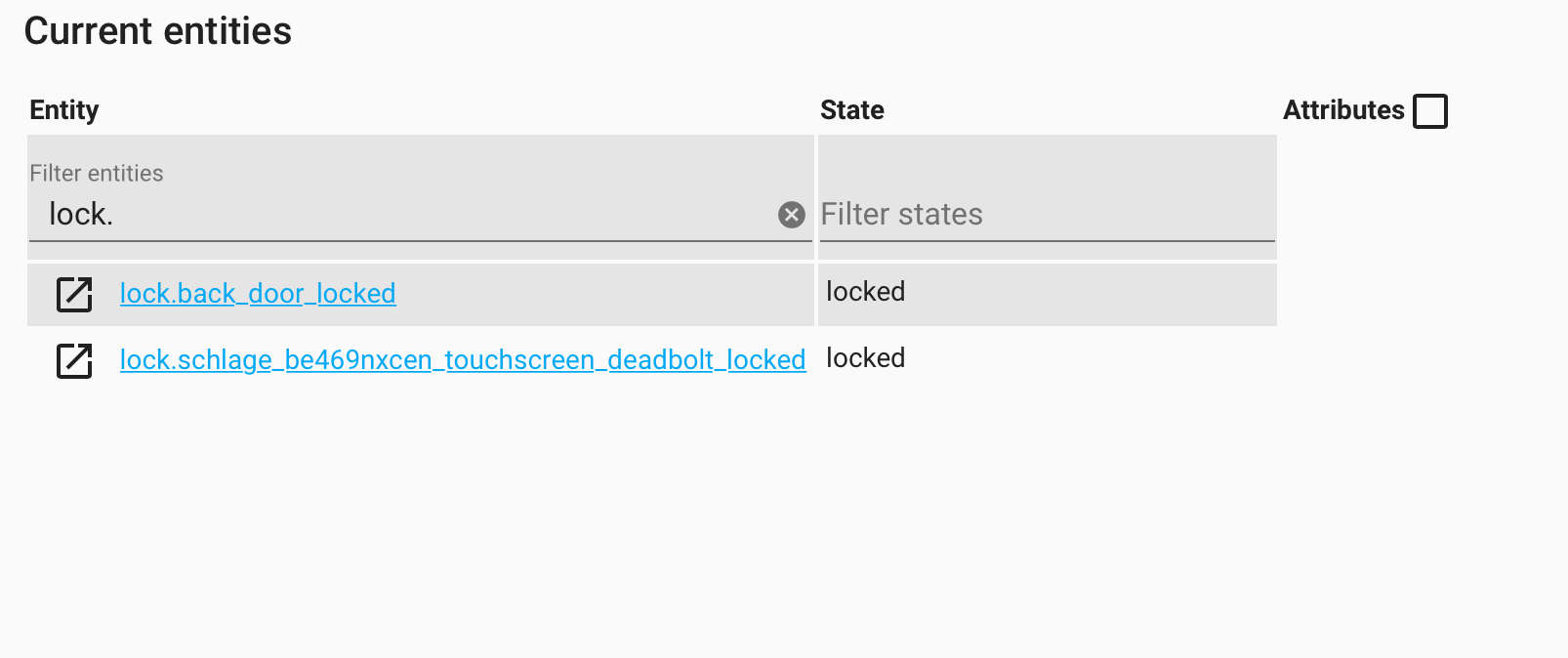

For example my back door lock is has this entity name in HA
lock.lock_back_door_lock
and my front is named
lock.lock_front_door_lock
If you’re have different names you either need to rename your locks (entities) or make a lot of changes in the yaml to match your name. It’s your choice, but for many renaming your locks is the easiest.
Edit the reason for the naming is that the input booleans, and several other items in the script just parse the name of the lock. For example
input_boolean.door_keypad_1_back_switch
relys on lock.lock_back_door_lock. It actually parses the name of the input boolean and pulls the word “BACK” to use elsewhere in the script then uses that here
            {% set object_id = trigger.to_state.object_id %}
            {% set lock_name = "_".join(object_id.split("_")[3:-1]) %}
            {% set lock_id = 'lock_' ~ lock_name ~ '_door_lock' %}
            {{ states['lock'][lock_id].attributes.node_id }}
lock_id ends up being the name of your lock
Hi , thanks for the explanation
Here is the place to change it right ? In my case what it should be ?
Seems that the system adds _locked to the end of the name there…
I renamed mine in the entity registry file here is what mine looks like for all sensors
Make sure to stop HA, make the changes, then start ha
