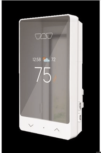

This is the device that I have. I setup my account from the app in playstore.

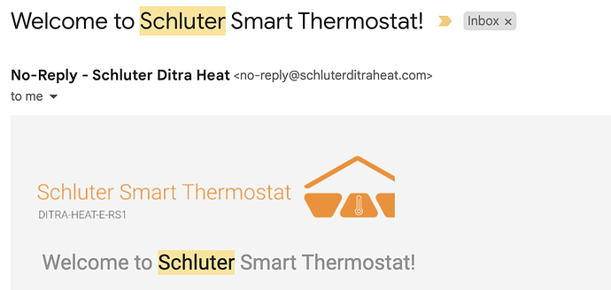

Same issue, the DITRA-HEAT-E-RS1 I just installed does not recognize the email address I used to register with the mobile app. Any workarounds for these models yet?

I don’t care for the mirrored face on the Schluter unit, but the hard temp adjust buttons are nice. It’s a simple one page display with no options but all the info available. The Schluter back wire terminals are superior to both Nuheat (rear clamps) and Watts (screws).

I have the newer E-RS1 thermostats. SchluterĀ®-DITRA-HEAT-E-RS1 | Thermostats | Schluter
It seems that they use a different account and possibly API to control it. This is controlled by a different app than the E-Wifi models:
