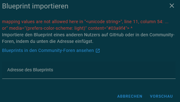

I get an error when I try to import this blueprint. I’ve tried others and they seem to work. Is this a legitimate error or am I doing something wrong?
Unfortunately not, I also get an error message …
I reposted the code (maybe i screwed up while pasting), tried to import it and worked. Can you check if you still get this error? Thanks.
Thank you very much. I had created it manually as a blueprint in the meantime, but now the link works again for me in Safari.
Import now works. Thanks for the fix.
