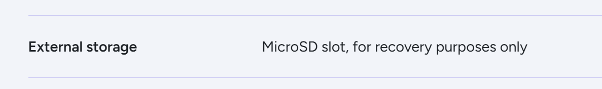

First things first - the SDCard is only used for recovery, as explained in the HA Green Docs
Secondly, have a look at this (grainy) gif. The Green accepts an SDCard upside down, so the wing should be the left of the card.
