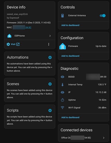

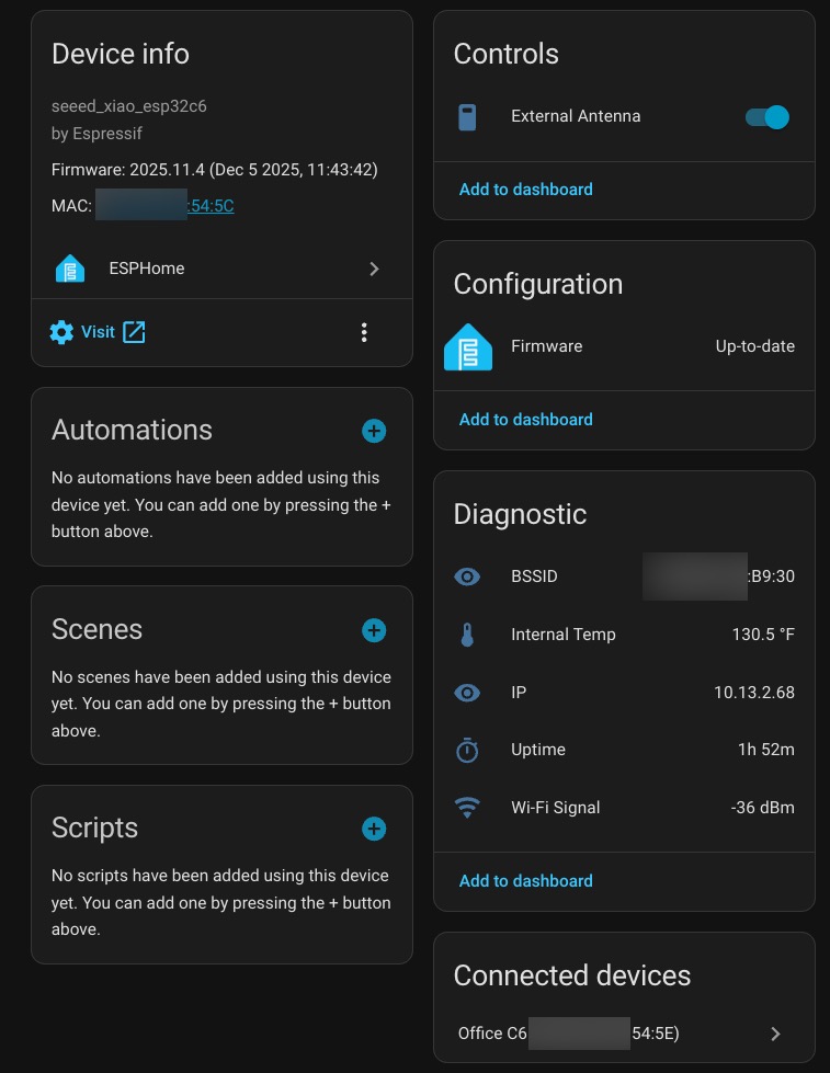

I’ve worked up a comprehensive Seeed Studio ESP32-c6 configuration which works with the latest HA (2025.12), and supports an external antenna. I also added more sensors. My configuration is tailored to ESPHome Device Builder, using a custom C6 package. It was NOT tested with any additional sensors. This is strictly for BT proxy and scanning.
It’s on my GitHub: GitHub - DerekSeaman/ESPHome-Seeed-Xiao-ESP32-C6-Config
