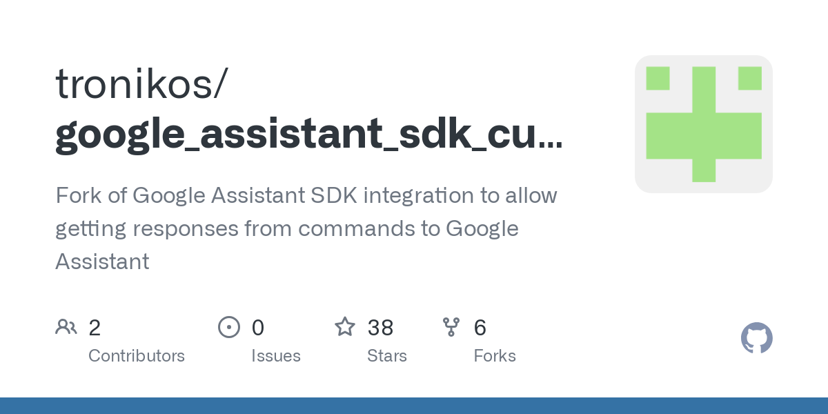

Hi @briis ,
Yes! There is a bug in Google Assistant, it may send HTML instead of text responses. And Home Assistant’s built-in integrations are not allowed to parse HTML for security reasons. Therefore you need to install this custom integration for Google Assistant SDK and it will work:
That did the trick. Thank you @MatrixRewriter
