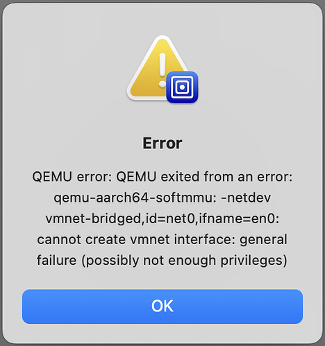

When I run the VM I get this error message:
QEMU error: QEMU exited from an error: qemu-aarch64-softmmu: -netdev vmnet-bridged,id=net0,ifname=en0: cannot create vmnet interface: general failure (possibly not enough privileges)
I know the installation should be correct because when I used a Shared Network, Home Assistance works, kind of. I could go through all the setup routines etc, however I have all sorts of dramas with detecting and pairing devices as would be expected.

I have no knowledge about MacOS and hypervisors, but I have a general knowledge and when using bridge network adapters it is necessary to put the physical network adapter into promiscuous mode.
You might not have a driver installed that allow it or you might not have the rights to set the adapter to that mode.
Thanks for your response WallyR. I had no idea what that means, so I looked it up and it sounds like I would create a security hole that way, which makes me uncomfortable with my limited networking knowledge. Besides all the information I found re promiscuous mode on a Mac is outdated and I couldn’t really find out how to enable it. The ifconfig command apparently used to support it, but Apple took it off a while back.
I have seen VMware and VirtualBox use promiscuous mode, so there must be a way to enable this safely. Do you have any further info?
Meanwhile I did some further testing with just a blank VM on UTM and it throws the error as well, so the issue isn’t really related to HA. Maybe I will see if I can raise the issue with UTM but I am not holding my breath.
Non-promiscuous mode means the net adapter will filter all packets away that are not having the adapter’s own MAC address as destination. This means your adapter can only accept packets for one host/IP address, so you can not run a bridge or switch emulation on that adapter.
@MOz I have an M2 Mac Mini working using bridged mode in UTM- I recall having a problem at first because I had selected the wrong network adapter (en0 vs en1 probably- I had to figure out which was ethernet instead of wifi).
I didn’t have to mess with the advanced options nor anyone’s promiscuity level…
