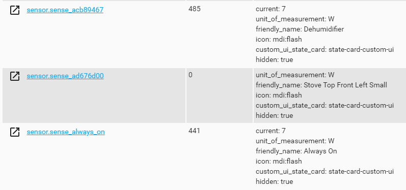

And here’s what the detailed state view of a few sensors looks like:
