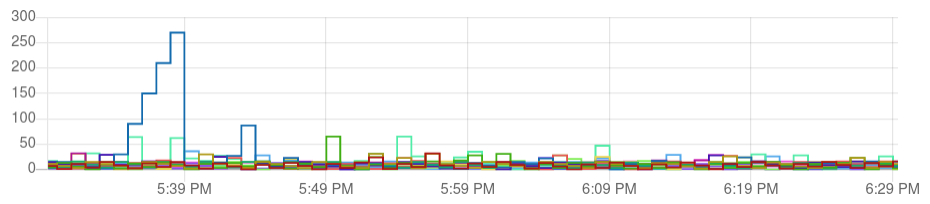

I think I’ve come up with an elegant way to do this which gives me lots of flexibility. If I set MQTT to force_update I could even graph it on Lovelace and have an overview of any outlier sensors that may have signal issues since the interval should be regular.

The messages from this single automation then end up looking like this - clean and concise easily letting me know what to check:
To me, as a software engineer, this seems much easier and more modular for maintenance than having to keep track of a mess of automation…I can just make the sensors as I make the MQTT sensors and then add 1 line to my notification alerts. If I decide I need to be alerted via another method, I only have to change 1 automation and I can have it (for example) blink a light or send an email instead of Telegram messages. If I decide to change the interval, I can change it in 1 place on the alert automation. If I add a sensor, I don’t have to worry about copying the correct alert logic, I can just add the new sensor to the existing list. If I want to add more actions, I can simply reference the known working age calculations.
