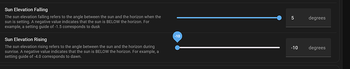

Thanks, however it seems that the sun elevation condition looks like a binary ON/OFF, i’d like a transition.
edit: I think i need to use BOTH the optional sun elevation AND what i’ve been using which is the dynamic settings.
One last thing, could you give the optional sun elevation settings a bit more of a range?
say, 15 to -15
Transition is used. Set it in the light control.
You can use toggle helper as the trigger 24/7, with dynamic lighting and the sun elevation. They will all work together.
Just type the number you would like and click save.
Blacky :smiley:

Just a suggestion, add option for sunset and sunrise, with time settings. For example switch on light at sunset - 1h, an hour earlier that sunset, you get the idea. Would be more useful than elevation in my opinion, and easier to customise the timings!
The FAQ has an explanation on why sun elevation is the recommended approach here. It’s easy to use and works pretty well!
@petrutms
Thanks for your suggestion, as @Nuwanda said you will find the link to the sun condition. I have also just updated it to reflect all the questions I have had in the last few post. You will find why I did it like this by clicking here.
A good example of why I used it is in this post recently click here
Blacky :smiley:
