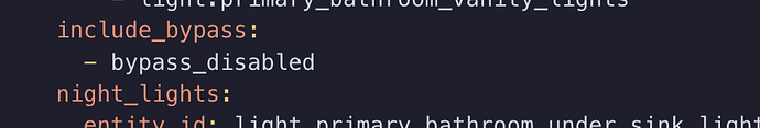

I had been having trouble with my automation after upgrading from V2 top V7. I do not use bypass, but after much debugging, I found that the bypass list was populated with bypass_disabled. It looked like this:
I removed it and made the list empty by editing the yaml:
include_bypass: []
This solved the issue. This may be too much of an edge case to matter, and I guess I could have remade the automation easily enough, since its a blueprint, but thought it would be good to let you know. It could probably be solved with an additional check in the bypass enabled check.
This is the trace where I found it. I can share the whole trace if it is helpful

Going from V2 to V7 there are many thing you had to do along the way. You can see them in the FAQ down the bottom. Best to just create a new automation fresh. Disable your existing one. Then create a new one. You can reference the old one as you to it. Then once your happy just delete the old automation.
Let us know how you go.
