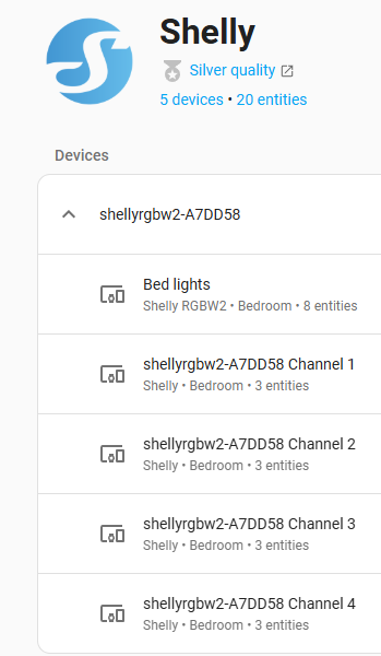

In this application I am using it for night lights. I have a string of RGB (not RGBW, important later) under the bed connected to a SHELLY RGB.

1: the RGB is just showing white.
(remember, its just an RGB strip.)

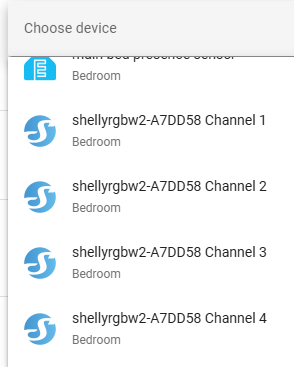

I have selected the entities for the Shelly RGB, chosen the colour and all it does is show white. i checked the YAML. as you will see below, it has the section to use the RGB section, and was not working. So i deleted the entries in your blueprint and you will see the updated code below.
