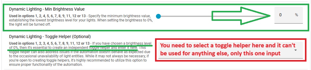

Thank you so much for the answer! Tried a bit on a script, but a bit unsure where to start. Do you have any overall suggestion on what is needed on this script?
@Blacky
Should a 09:00–23:30 time condition force occupancy-controlled lights to turn off right at 23:30, even if the room is still occupied?
Still have this issue, which is different to what I'd expected. Is that correct behaviour for the blueprint?
@ryanhindinger
Perfect best to just ask and provide your YAML :+1:. There is a lot in the blueprint to get your head around.
Simply just add a toggle helper into Dynamic Lighting - Toggle Helper and you bee good to go. See below.
