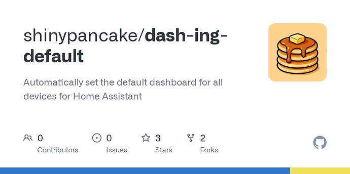

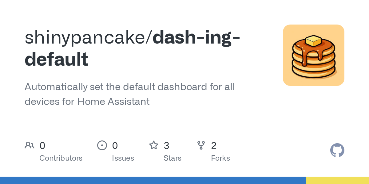

This author has stopped maintaining it due to lack of demand, but there is a fork of it, and I tested that it works fine.
