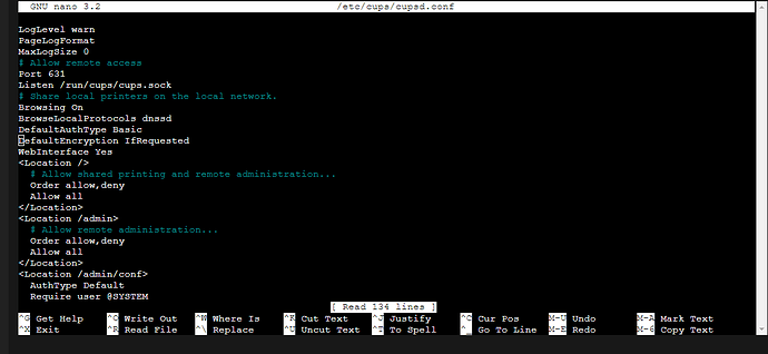

  1. This Cups version does not let you add new printers from outside the system (-> the website). So you have to change the config-file. For that go into the newly created Container, select “Console” and connect to it:
There is no file editor installed, so you have to install it by typing the commands:
apt-get update
apt-get install nano
now you can edit the config file by typing:
nano /etc/cups/cupsd.conf
And add DefaultEncryption IfRequested after DefaultAuthType Basic.
Save with “CTRL-S” and close it with “CTRL-X”. Now you can add your Local USB Printer in Cups through the website.
