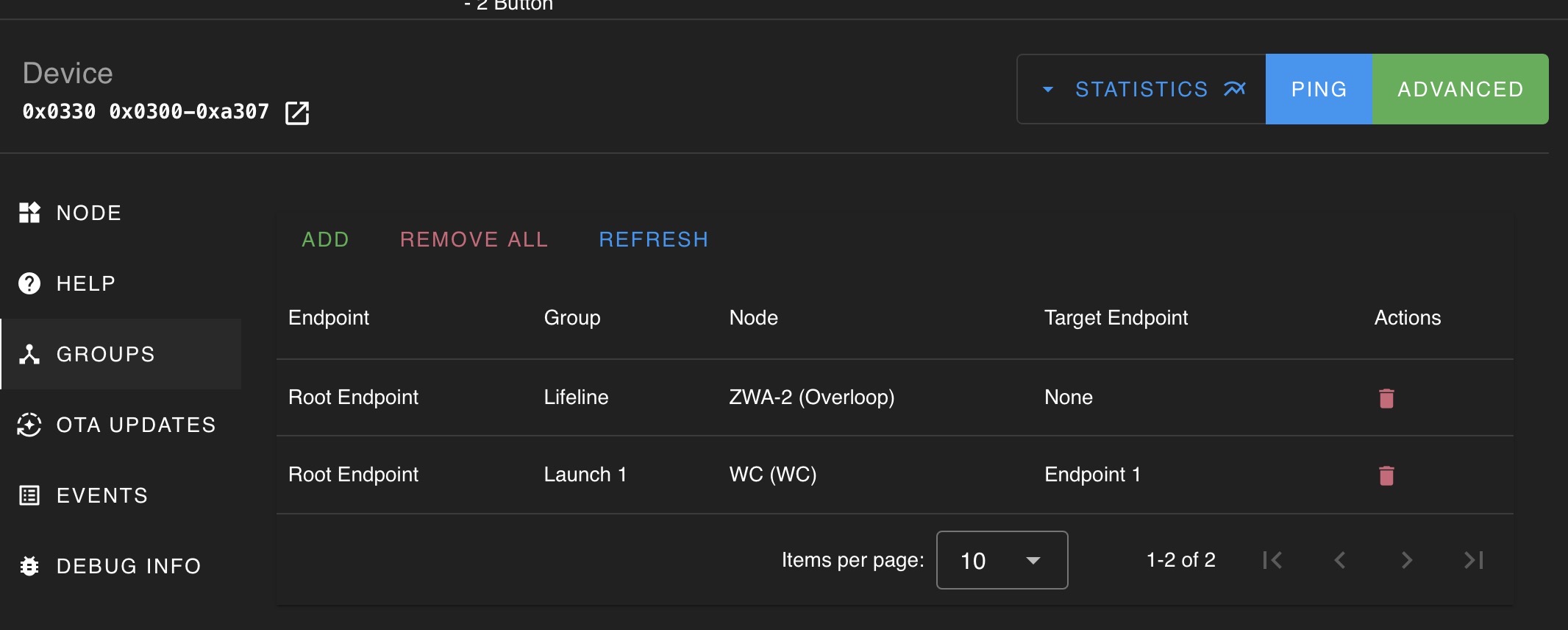

Do you use z-waveJS or ZwaveJS-UI? For the latter go to the Addon webUI, pick a node, select groups on the left:
For battery operated devices mke sure you wake them before applying changes.

Thanks for your replies. Yes, I’ve seen the tutorial above but my problem is that I can’t seem to find the interface/section posted by Edwin (and in the tutorial linked above)
looks like I’m on Z-Wave JS.
ZVaveJS was also explained in the post I linked you to.
Thanks Edwin, I’ve installed the Zwave JS UI add on but it looks like I’m going to need to configure all my devices, scenes and automations again if I switch to this add on. There is no option to set association with the default add-on? Thank you
Setting associations from HA is technically possible but difficult and not advised.
You can migrate your existing configuration instead of starting over.
