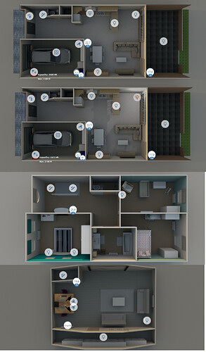

I am sharing below my floor plan, but I also have an issue that would like to check is someone know the cause
So, this is my new floorplan, fully re-built since I moved to a new house
The issue:

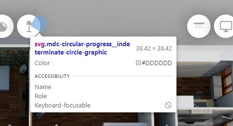

There is a spinning wheel presented in both mobile browser, app and PC browser always spinning on top of my floorplan:
<div role="progressbar" aria-valuemin="0" aria-valuemax="1" class="mdc-circular-progress mdc-circular-progress--indeterminate " style="width:28px;height:28px;">
<!--?lit$44837221$-->
<div class="mdc-circular-progress__determinate-container">
<svg class="mdc-circular-progress__determinate-circle-graphic" viewBox="0 0 28 28">
<circle class="mdc-circular-progress__determinate-track" cx="14" cy="14" r="10" stroke-width="2.6666666666666665"></circle>
<circle class="mdc-circular-progress__determinate-circle" cx="14" cy="14" r="10" stroke-dasharray="62.831852" stroke-dashoffset="62.831852" stroke-width="2.6666666666666665"></circle>
</svg>
</div>
<div class="mdc-circular-progress__indeterminate-container">
<div class="mdc-circular-progress__spinner-layer">
<div class="mdc-circular-progress__circle-clipper mdc-circular-progress__circle-left">
<svg class="mdc-circular-progress__indeterminate-circle-graphic" viewBox="0 0 28 28">
<circle cx="14" cy="14" r="10" stroke-dasharray="62.831852" stroke-dashoffset="31.415926" stroke-width="2.6666666666666665"></circle>
</svg>
</div>
<div class="mdc-circular-progress__gap-patch">
<circle cx="14" cy="14" r="10" stroke-dasharray="62.831852" stroke-dashoffset="31.415926" stroke-width="2.1333333333333333"></circle>
</svg>
</div>
<div class="mdc-circular-progress__circle-clipper mdc-circular-progress__circle-right">
</svg>
</div>
</div>
</div>
</div>
Does anyone know what this is and how to stop it?
“mdc-circular-progress” doesn’t appear anywhere in the ha-floorplan github so I am thinking it is not related. How have you set floorplan up? Have you done anything non-standard? Are you running it in an unsupported environment? You can test by creating another floorplan with a single rectangle in it or something else super simple and see if it happens with that? If not then maybe you have done something unusual with your SVG?
Well,
It does appear in a “ha-circular-progress class”
<div class="progress-container" style="height:100px;">
<ha-circular-progress class="render-spinner" active="" size="small" progress="0"></ha-circular-progress>
</div>
I really have nothing weird. I can try a simpler card this afternoon to check is it also appears.

I spent my time designing my floorplan and I would like to share my result with you.
I would still need to include more information like the consumptions etc…
Also I’m blocked when I would like custom popups for some devices.
Main floor:
Main floor when a light is on for example:
1st and 2nd floors:
Thanks,

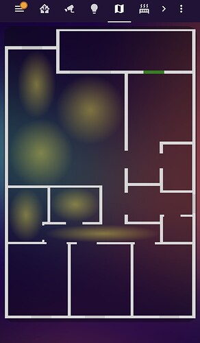

Here is my simple 2D floorplan. For now only windows and lights have been incorporated. When I tap on a room it toggles the light. Also turns windows green when left open
I’m going to do this, thx!
