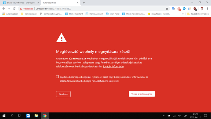

The link in above post re-directs to nasty stuff. I think you side has been hacked
GOSH!!! Thank you for the heads up!!!
Can you share your theme ?
I still am re-directed
Something wrong with the website…
Apologies yet again @krovachek @Tyfoon this is just getting ridiculous!! The website is back up again and I’ve now added extra security so fingers crossed this doesn’t happen again!!
