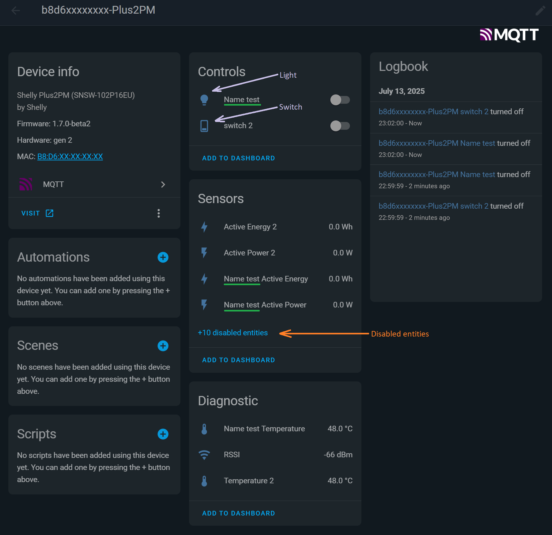

Then, I came up with the idea of a complementary script, which will register hosting devices to MQTT discovery. And here is. So far, limited to following components:
  • switch (can be reported as a light)
  • cover (incl. position and slat if enabled)

I’ve tested the models I own:
  • Shelly 1 gen3
  • Shelly Mini PM gen3
  • Shelly Plus 1PM (gen2)
  • Shelly Plus 2PM (gen2) - as switch, light, cover incl. position and slat support
  • Shelly Pro EM3 (gen2) - both triphase and monophase profiles
  • Addon Plus - with 4xDS18B20, DHT22, binary, analog and voltimeter inputs
However, it will create sensors out of all the Shelies that utilize the components listed above. Here is a compatibility list: shelly-scripts/scripts/mqtt-discovery-self.md at main · michalk-k/shelly-scripts · GitHub
