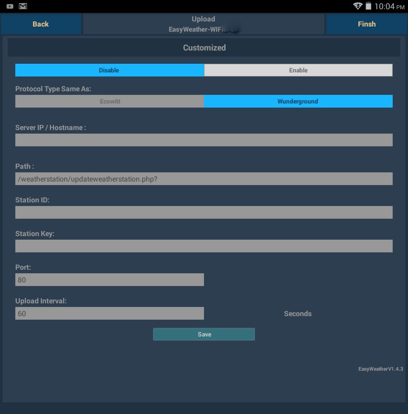

I see the Ecowitt WH series weather stations (AKA FineOffset) like the WH2900 and probably WH2950 now have included in their new firmwares, what seems to be a generic server destination upload config screen, for using either WU protocol or Ecowitts own. They still have the other old config screens for entering WU, WOW or WeatherCloud site names & keys etc like before, this one is new.
I’m not sure if this means with the right database server running on HA, a home station could now upload to HA directly with no hacking or cloud stuff.
Does that below look like what this may mean, from WS View (Ecowitts weather station setup App) ?
Just found out some more about the Ecowitt ( Fine Offest) wifi stations and the custom upload to private server.
It does do that now, gold mine of info here. Somebody has also got it to upload to PWSweather…
https://www.wxforum.net/index.php?topic=36932.25
I have never setup a custom database server on anything in my life, let alone on Linux on HA’s RPi, so the actual doing of this is going to have to wait for a smarter HA user than me :slight_smile:
You can use the ecowitt to send data to a personal server, and then send that data to HomeAssistant via MQTT. There’s an existing project to do this for you: https://github.com/iz0qwm/ecowitt_http_gateway but it requires a lot of stuff to get working (PHP, Apache). It seems that something like weewx can also be useful in this regard, but again there’s some setup. Personally I wanted something super simple that just gets the request from the weather station, format’s it as MQTT and sends it to HA, so I wrote this: https://gitlab.com/gabeguz/ecowitt it’s a Go program that listens for HTTP connections from the ecowitt gateway, transforms them into MQTT messages that HomeAssistant can understand. It’s very much a work in progress and there’s 0 documentation so far, but it’s working to get my ecowitt sensor data into HA!
