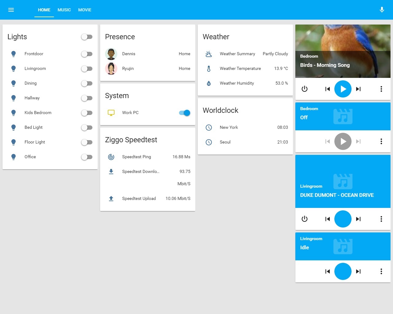

I now have
  • a button that can turn my pc on and off.
  • automation that turns my pc off when I leave the house
  • automation that turns my pc on when I turn on my office light at night.
  • automation that turns my pc off when I turn off my office light at night.
All while my units speaks to me…literally.
