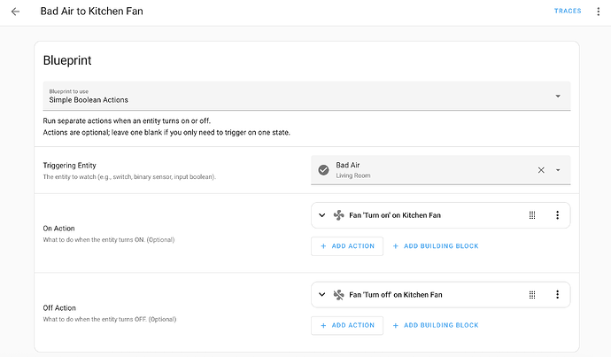

Following up on the fame, acclaim, and riches brought by my “Simple High/Low Threshold Actions” blueprint, I introduce: Simple Boolean Actions. Another super basic blueprint that is literally just a super lazy way of doing thing A when something turns on, and thing B when that thing turns off. Between the thresholds actions and now this boolean one about 90% of my basic automations are covered.
EXAMPLE PIC
IMPORT HERE

THE YAML
blueprint:
  name: Simple Boolean Actions
  description: |
    Run separate actions when an entity turns on or off.
    Actions are optional; leave one blank if you only need to trigger on one state.
  domain: automation
  input:
    triggering_entity:
      description: "The entity to watch (e.g., switch, binary sensor, input boolean)."
      selector:
        entity:
          # Domains that typically have on/off states
          filter:
            - domain: "binary_sensor"
            - domain: "switch"
            - domain: "light"
            - domain: "input_boolean"
            - domain: "schedule"
    on_action:
      description: "What to do when the entity turns ON. (Optional)"
      selector:
        action: {}
      default: []
    off_action:
      description: "What to do when the entity turns OFF. (Optional)"
      selector:
        action: {}
      default: []
    additional_conditions:
      name: Additional Conditions (Optional)
      description: A list of extra conditions that must be true for either action to run
      selector:
        condition:
      default: []
trigger:
  - platform: "state"
    entity_id: !input "triggering_entity"
    to: "on"
  - platform: "state"
    to: "off"
condition: !input additional_conditions
actions:
  - choose:
      - conditions:
          - condition: "trigger"
        sequence: !input "on_action"
      - conditions:
        sequence: !input "off_action"
mode: "single"
