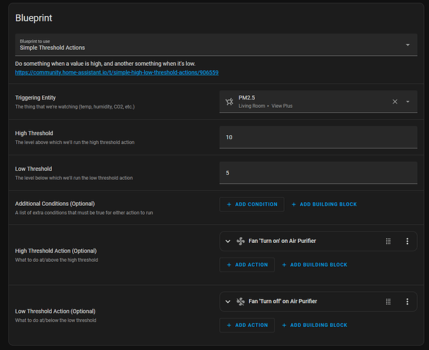

I frequently find myself turning things on/off based on low and high thresholds, so I made this blueprint so I can be extra lazy in setting them up. (And hopefully making it so my end users can be a bit self sufficient if they want to tune their systems.)
Example use cases:
- Turn the basement dehumidifier on when humidity is above 60, and off when it’s below 50
- Turn the bathroom exhaust fan on/off based on humidity (there’s dedicated blueprints for this if you want fancier features like timers)
- Turn on the AC in my office-cum-MDF when temp is high and off when it’s low
- Turn on the air purifier when PM2.5 exceeds a threshold, then off when it’s safe
- Do something when CO2 is too high
- etc
This is consciously and explicitly a barebones and simple automation. Want something fancier, like averaged sensors or setpoints that can be updated via other automations? Use helpers.
TODO:
Expand beyond sensors as inputs and switches as outputs- Figure out the real reason why kids love cinnamon toast crunch
EXAMPLE SCREENSHOT:
