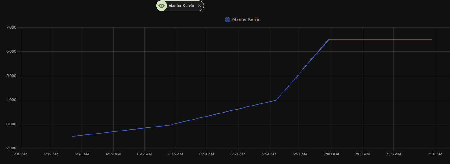

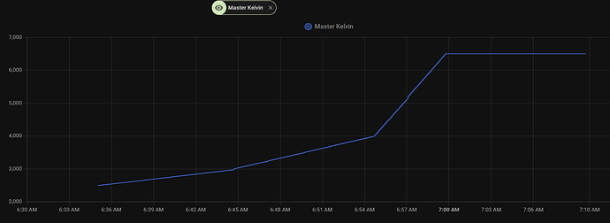

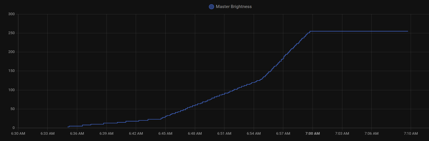

Overview
Basically it contains 2 components. The first component is a script that is executed 3 times in series to change the rates of the 2 main settings, kelvin and brightness. By running it many times you get get a more parabolic effect. I added this feature because I could visually detect changes in brightness more at lower values when increasing using a linear increase in brightness or calculated parabolic curve.
Below is an example of it in action. You can see the points of which the values change.
The second component is an automation that executes the script 3 times in series with different values for each execution.

Execute the script 3 times with the given parameters to get the desired parabolic curve.
