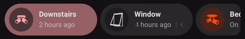

Carousel mode:
Carousel view mode

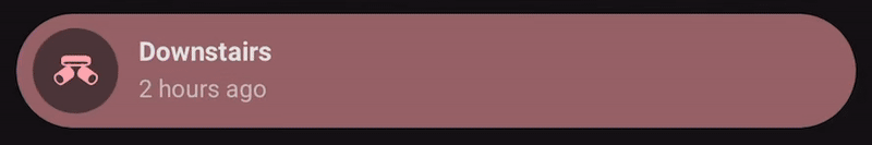

Single mode:
Single view mode
