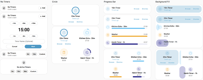

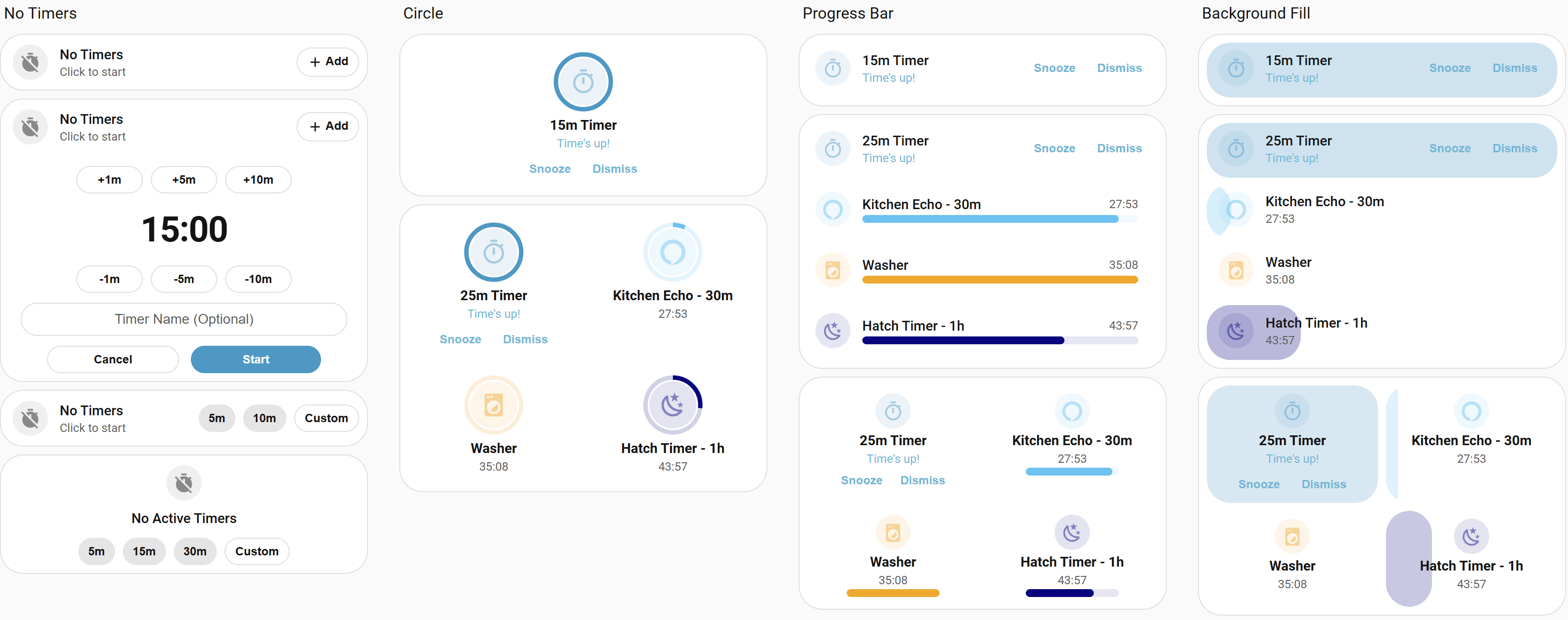

  • Display multiple timers in one card
  • Different layouts (list, circle, vertical)
  • Works with Voice PE timers, Alexa timers, washer/dryer cycles (works with my Samsung appliances), or any time-based entity
  • Simple, minimal design that fits right into Lovelace

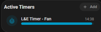

This is what it looks like now:
:+1:
When I change any of the other attributes in the UI like color or icon, it changes to auto and I have to go back to the code editor to manually set it back to timer

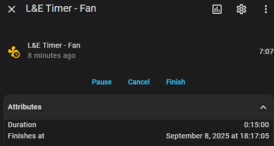

Here are also all attributes from the Developer Tools - States tab:
duration: 0:15:00
editable: true
restore: true
icon: mdi:fan-clock
friendly_name: L&E Timer - Fan
finishes_at: 2025-09-09T01:17:05+00:00
remaining: 0:15:00

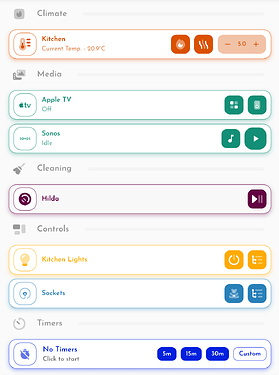

Screenshot 2025-10-29 at 10.05.36

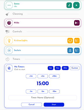

other wise I have it looking like I wanted. Inspiration for anyone:
Thanks! Your setup looks great. Right now there’s no option to change the “no timers” icon, but you can adjust the secondary text color using card-mod. Just note it’ll also affect the timer action buttons and secondary info:
