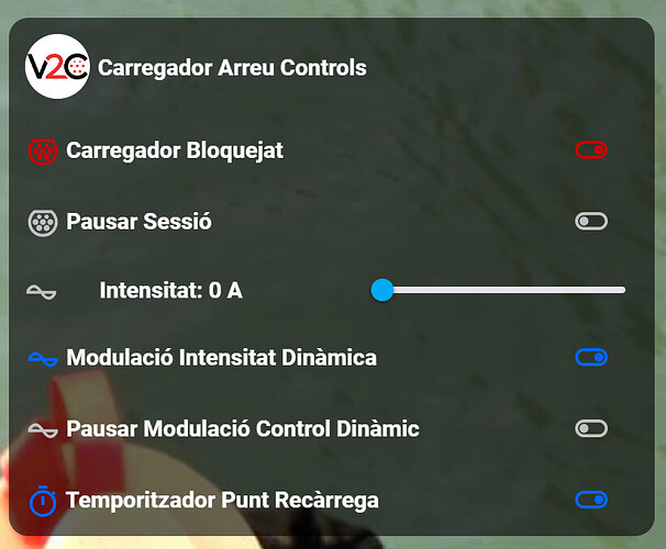

Dear all (and Ildar) :wink:
I’m using the slider-entity-row to display the intensity value (shown below) and I was able to change several parameters, as shown in the code, except for the margin-left ?
I would like to align the text with the others. If I use the inspector, I succeed to change several parameters to achieve this, like putting ā€œmargin-left: -5px;ā€ in .info or in .info.pointer.text-content, but I don’t succeed inside the code below. Sorry I’m not really an expert…
The following is the card_mod parameters I use in the main card:
  card_mod:
    style: |
      :host {
        --primary-text-color: White;
        --paper-item-icon-color: Silver;
        --mdc-icon-size: 22px;
      ha-card.button-card-main {
        font-size: 14px !important;
        font-weight: bold !important;
      #container {
        text-align: left !important;
And the following code is the slider-entity-row as part of the custom_fields:
  custom_fields:
    intens:
      card:
        type: "custom:slider-entity-row"
        entity: "[[[ return variables.var_intensidad_num_entity ]]]"
        name: '[[[ return states[variables.var_intensidad_num_entity].state == "unavailable" ? "Intensitat: ?" : "Intensitat: " + Number(states[variables.var_intensidad_num_entity].state).toLocaleString("de-DE") + " A" ]]]'
        full_row: false
        hide_state: true
        grow: true
        min: 6
        max: 32
        step: 1
Am I doing something wrong?
Many thanks!
is this inside a button-card?
why not simply use an entities card there (thats what this slider was designed for after all :wink: )? no aligning problems in that case. You’d have the average on the right side ofc, but that might not be an issue.
if you want to keep it like a custom field, you should experiment with left padding and/or margin probably
did you already do that?
