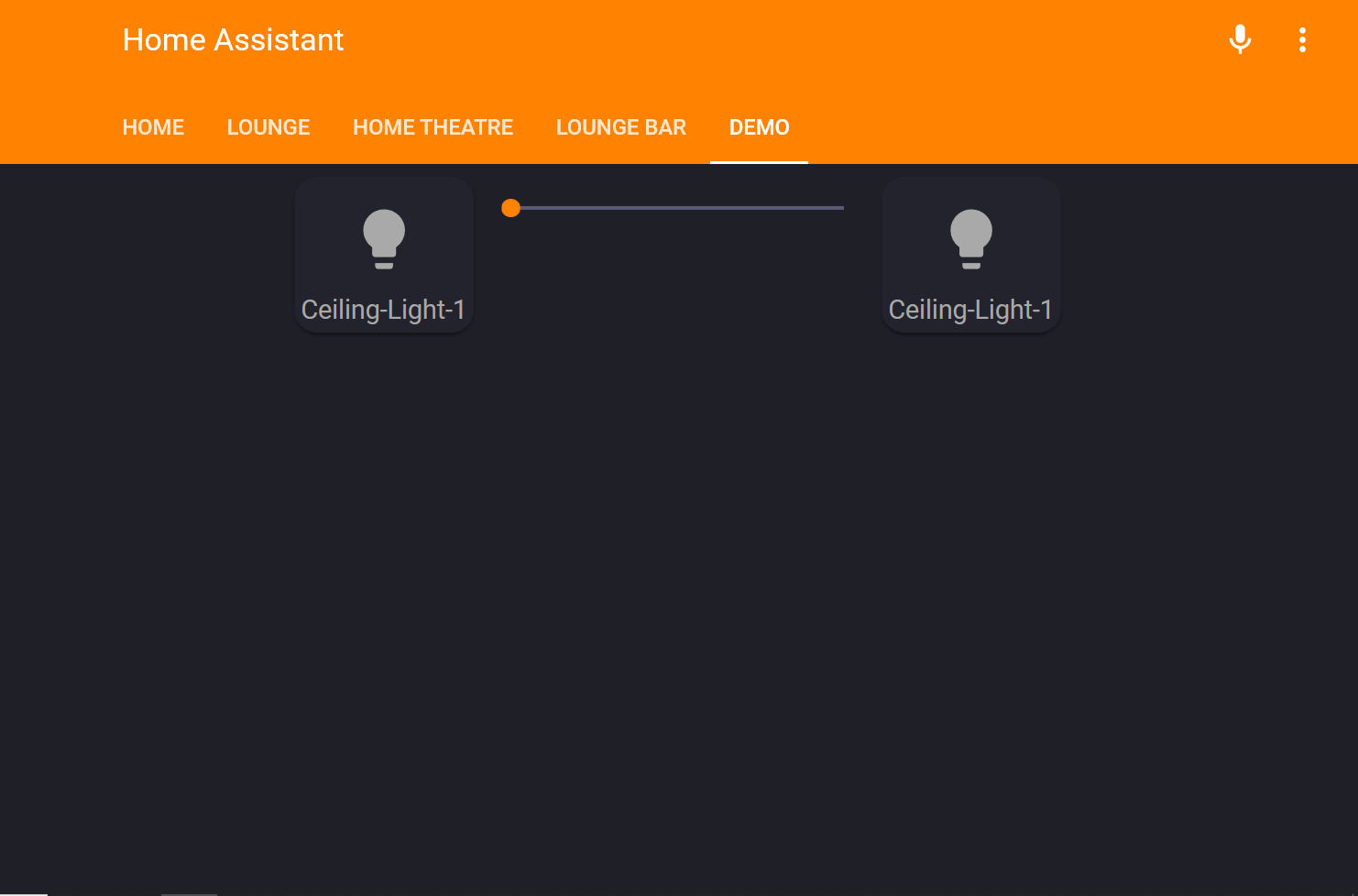

I tried to do changes in lovelace yaml file to make slider position in center of both buttons but doesn’t change at all.then i tried to change in sliderentityrow.js by adding padding or change the height of the slider card but ui doesnt change at all
I’d suggest you put all three of those in a picture-elements card. Then you can place things exactly where you’d like. [This] should help.
thanks for your reply u mean i should add button card and slider entity card to a picture elements card, sure I’ll give it a try, BTW one more thing I want to ask how can I hide slider for OFF state
There’s an option for that. It’s in the readme.

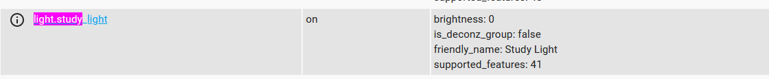

A tiny little bug I’ve found is that when toggle: true, hide_when_off: true. When the lights turn on at minimal brightness (some bulbs default to this), the slider doesn’t appear.
It seems I have to get close to 5% (slider minimal brightness before turning off at 0%) for the slider to appear.
Try changing step: to something smaller, like 1.
Just tried settings step to 1, still doesn’t appear :frowning:
I think I see the problem
Some lights do this because in automation templates, I set brightness to 0 to turn it off. But this means when turning on, it will be lit at minimum brightness but with brightness attribute of 0.
I’m guessing your plug-in hide_when_off options works on the basis if brightness is 0, it must be off?
I’m unsure if this is a HA core bug or plug-in bug… if light up on, minimal brightness should be 1.
EDIT: Everything working great after upgrading to v0.107! O happy days!! :smiley:
