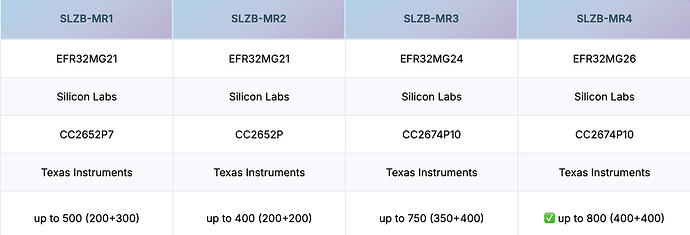

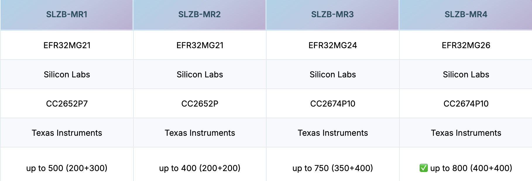

I am in the same boat. slzb-06 works perfectly on CC2652P. I chose to run the Z2M on CC2674P10 on the MR3.
The network has no issues on the 06 but within a 24 hour window dropped 40 odd wired devices out of 70 on the MR3.
Smlight have been kind enough to send me another MR3 but the issue persists. Been trying for months now.
Have to stop Z2M, reboot MR3 and OS and Zigbee restart. Then wait a few minutes to start Z2M for it to work. Most often still fails to start Z2M

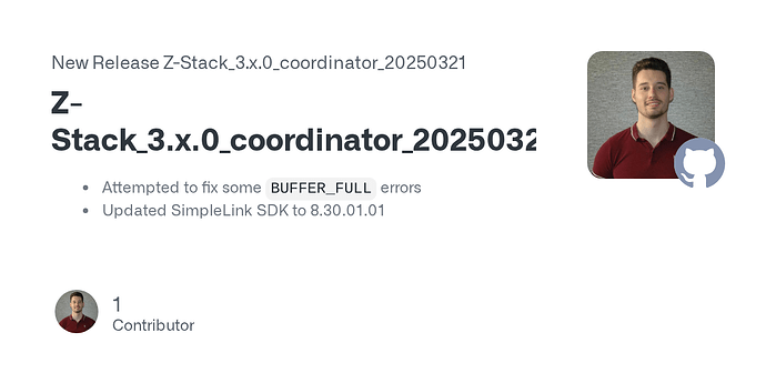

If you look at the latest zstack firmware release,
you will not find firmware for CC2674P10
Reason enough for me not to use a CC2674P10
@Francis – Interesting find on the Zstack firmware. Is there a similar one for ember?

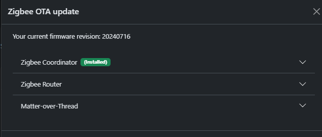

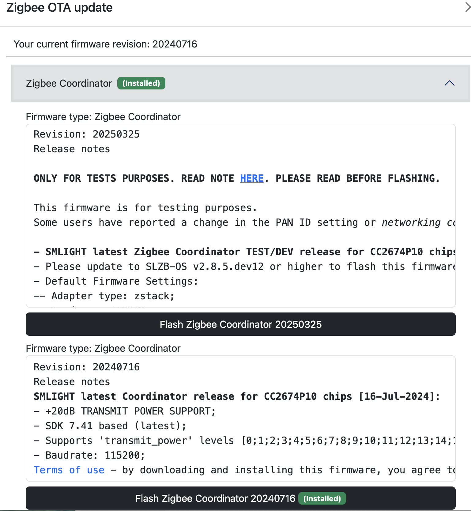

CC2674P10 - Now flashed to Zigbee Coordinator version 20240716 (Which I’m actually wondering what z-stack firmware they are using??)

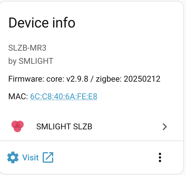

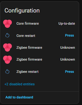

The 20250212 firmware has me bugged though. It shows in the smlight integration I am on it but the web interface shows I am on 20240716 for zigbee.
Can you confirm this?
Got this on both MR3’s.
Notice it does not mention the firmware date here.
but here I have this
Can you explain what this means for us idiots? Do you mean the firmware which comes with the mr3 for the CC2674P10 is not working?
Since Zigbee2mqtt started, koenkk has always provided the firmware for Ti chipsets. He has not yet released a firmware for CC2674P10, so smlight must have created one themselves. Obviously, koenkk knows a lot more about Zigbee2mqtt then smlight, so I wonder why ?

@Mrsash I have similar issue with reporting as you. I’m not sure it bothers me all that much
Here is my display:
Hmm I am not bothered if it works. I am just trying to understand if this causes any issues. The 06 shows me the firmware version fine from memory. I mean the Configuration info in the intergation
If you’ve ever touched base with any of the SMLZ Light staff through their support system on their website, they often have a lot of UI bugs. Makes you wonder if their are other bugs besides UI bugs we aren’t seeing. Anyway if bothered by the discrepancy, open up a support ticket and include your images. They will likely acknowledge the mistake and fix it in the next release. They are pretty good about taking user input and making changes.
