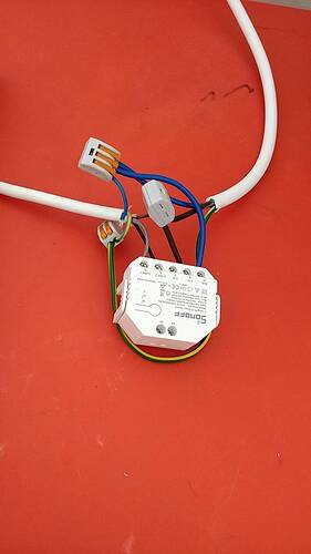

Thanks for sharing, I wonder if I can use Sonoff Dual R3 instead of Shelly
If you want to go dead-simple, what I did is just use a Z-Wave outlet with an Add-A-Motor which can pull standard curtain pulls. Nothing complex, turn the outlet on to activate the motor.
Is this applicable for the Dooya DT82TV? because I have the same motor and I wish to use it. It is the same motor that @Chrismox have and I happen to have extra Sonoff Dual R3 I want to know if the wiring will be the same as shelly which he used.
Thanks
I will answer my own question, I have tried the Sonoff Dual R3 with the same wiring as @Chrismox and it worked also worth to mention that the motor will not work if the L wire is not connected, it should be connected.
the functionality of calibration in the eWelink app is not possible I don’t know why. But the main thing for me solved and now I’m enjoying the new curtain motor.
