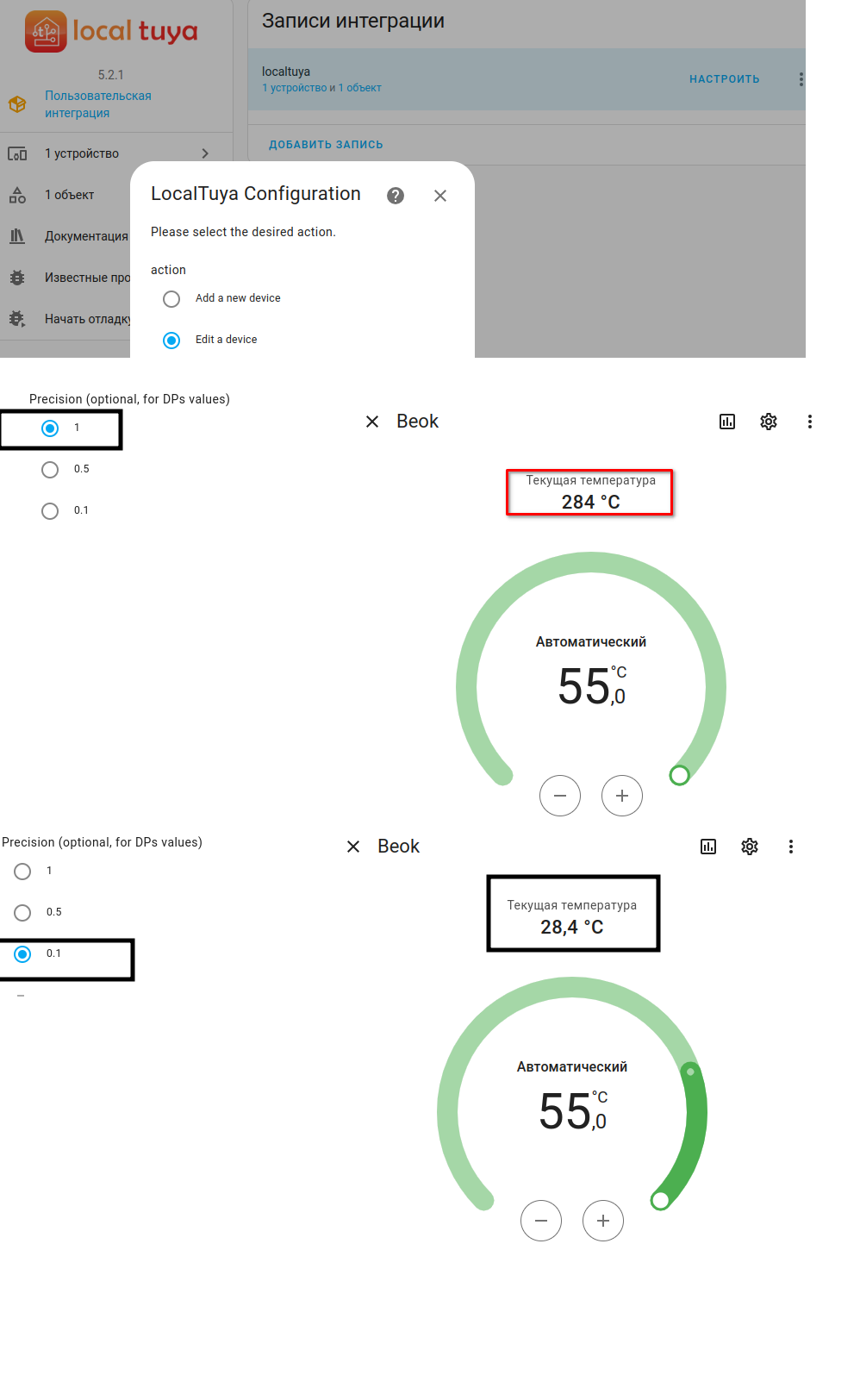

Just use tuya local and everything will work fine

Thank you very much for this work! Having figured it out, made a few adjustments, I added my 8 thermostats and now everything works and is displayed correctly! Well done!
